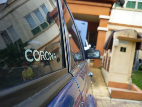

hai,
My car is For Sale.
Toyota Corona ST150 year 1986
Engine: 3S-GTE (transplanted 2003, registered with documents)
Transmission: 5 speed manual (using MR2 SW20 gearbox; E153)
HKS Power Flow (filter element 85% new)
NRG Boost Meter
Apex-i Pen Type Turbo Timer
Pivot Speed Meter
HKS Blow-Off Valve (cap ayam)
TIAL Wastegate ( cap ayam)
Fuel Pressure Meter
Silicon hose from turbine to intercooler
Pioneer Carrozerria Double Din Cd/Md Player
GT SPEC/HWL absorber adjustable hi-lo
16" LENSO Rim, with BARUM tyres (80% thread left)
The timing belt, belt tensioner and bearing have just been changed around 15,000km ago. Spark plugs also have been changed to Denso Irridium 8,000km ago.
Thats all I can think off right now as I havent remember what else was there. The engine is in good condition.
The only PROBLEM@ abandoned work at this car just aircond system. Problem related to compressor pulley got abnormal sound.
It could need some works coz got only some minor problem here and there. Who knows if you have money you can rebuilt it, good as a project car. As from the last time I drive it still kicked ass.
The car now is now at my hometown Pasir Mas, Kelantan
Price tag: RM 9000.00 nego
Of course cash buyer please.
As I am in Bintulu, Sarawak right now, any enquiries you can PM me here or email me at [email protected]
Or you can call my brother Annuar at 012-4516327 for a test drive & evaluation.
Forgot to mention it got a fuel surge tank & external pump installed on the rear boot, so there's no fuel delivery problem during cornering even at low fuel.
