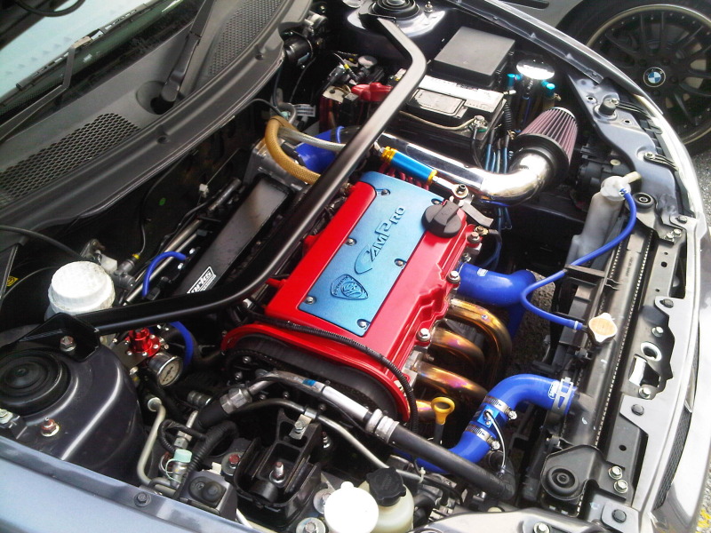

Helo ZTH members,just wanna share info and my car mods with all u guys.comments and feedbacks would be appreciated.thanks.
Interrior and cockpit:
-sscus euro 1 pair(swap ngan kawan)
-short shift ayam (REV Performance)
-works teflon gearknob (REV Performance)
-Defi ayam water temp,oil press,oil temp (mudah.my)
-stereng 3R ayam (Kedai Abang)
-Double Din touchscreen Taiwan (Max Audio Setapak)
-Neo OEM Double Din Casing (Kedai Abang)
-aluminium Pedal ayam (Kedai Abangg)
-Original Timer Apexi (member bagi)
-D1 Throttle Controller (EA Autoworks)
Exterior:
-Bodykit fiberglass R3 (After12)
-Bodykit painting and Custom front bumper (MegaSpray)
-Evo X plate Holder (After12)
-Lotus fender (GT Proshop)
Chassis and Wheel:
-Gab spring (Kedai Tayar Danau Kota)
-rim 15" volk racing taiwan + Yokohama A-drive Tyre ( Kedai Tayar Taman Putra Ampang)
-front upper strut bar Ultra Racing (EA Autoworks)
Engine and Performance:
-Original Cusco Oil Catch tank (After12)
-Original K&N air filter (REV Performance)
-NGK iridium Plugs 1 set (REV Performance)
-Aerospeed Plug Cable (Rev Performance)
-Matspeed Camshaft (REV Performance)
-Venom Aluminium intake manifold (REV Performance)
-Works Fuel rail (REV Performance)
-works campuley (REV Performance)
-Works crank pulley (REV Performance)
-Original Sard Regulator + meter (REV Performance)
-Samco Radiator Hose (REV Performance)
-Hks ayam water temp adapter (Topsound Performance)
-Jasma oil temp and press adapter (Topsound Performance)
-Jasma Universal engine damper (Topsound Performance)
-Custom Bracket for engine damper (JianHang Exhaust)
-Custom stainless steel air intake (JianHang Exhaust)
-Custom 2" centerpipe (JianHang Exhaust)
-Matola S Flow Muffler (JianHang Exhaust)
-4-2-1 Turbo-S extractor (REV Performance)
-Unichip Q piggyback (mudah.my)
-Unichip installation and tuning (RS Dynotune)
Coming soon brake upgrades,aluminium radiator,gearbox and clutch,port polish and TB bore and lastly retune ecu.

Dyno Chart !Low end power still a bit lacking but a I manage to push til 16Xwhp,a bit suprised sebab piston,head,gearbox sume still standard....masih ada ruang untuk improvement!!

Thanks guys...FYI engine internal is still stock except the camshaft,gearbox also still stock including OEM clutch.I'm posting this so that to show ppl that use campro engine to know that there is still a lot of improvement can be done to this NA engine.
Wsukun :hehehe thanks bro,the list I think would make ppl easier to know the price and where to buy the item.nothing secret in my modding,just helping other owners share some knowledge. :)

mao_3873 : 1st bought it was stainless steel chrome but now turning like gold with titanium burnt effect like. :p
