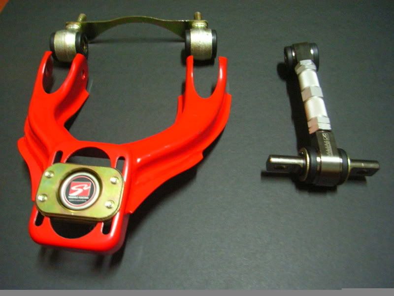

I opted for the S2 Pro Plus series, that came with the polyurethane bushes, along with the S2 rears.

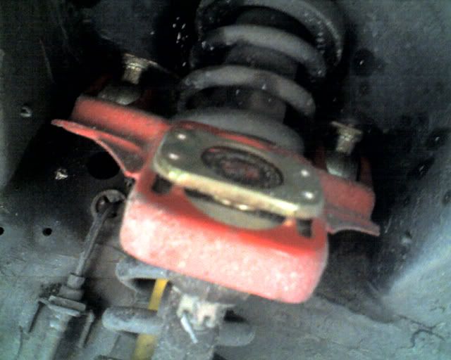

The ball joint adjuster plate/whatever it's called mount: Torque for the allen bolts are 7lbs-ft only, so don't torque them too much because you'd be leaving a dent on those arms.
You need to torque the bolts for the arm mounts while the the car is loaded (i.e the knuckles not dangling) so you don't preload the bushes and cause premature wear.

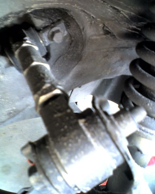

Grease, skunk2 doesn't really say much, apart from "Don't use petroleum based grease" which is like 99% of the grease on the Malaysian market. I ended up using polyurethane grease from SuperPro. Skunk2 says you can run them without grease, but squeaks is something you have to live with.. So I opted to using the superpro grease, so far, it's pretty quiet.. no discernible squeaks I can notice... . the superpro grease is quite resistant to water (I actually tested this, lol) though it's not really a heat-resistant type, so it can't really stand high temps.

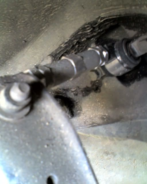

The rears.. Actually I just left them at the same length with the original R ones.
Not really a required part, because you can use spacers in liew of these, but I just like the beefiness of them, compared to the stock units.

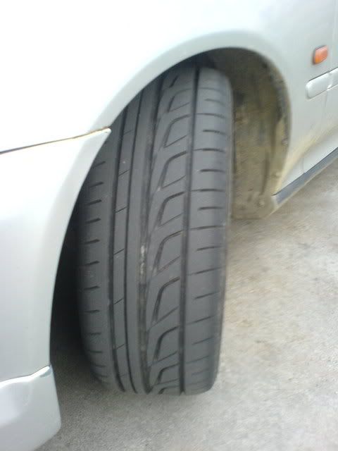

I'm running these tires now
They're Bridgestone RE001-Adrenaline 205/50/15. I changed all four to these. (thanks to rising prices of semis, I can't daily drive on semi's no more.), I almost went for Toyo R888s, but the coming rainy season made me think otherwise. Semis are crap in the rain.
Grip wise, of course not as good as my previous RT-215 semi-slicks, and the tire sidewall isn't that hard either, but can't really complain for the price. I think they're quite okay. They're meant for 15x7 wheels I think, but I fitted them on 15x6.5 CTR wheels. The rears 'just' clears the fenders, so no scraping.
they're a bit smaller than 195/55/15, reducing total diameter of wheel+tires from 595.5mm to 586mm

but the rear can DIY i think shorten the arm,... got one tyre shop mechanic specialize in this, but at the moment he's MIA,...

Yes, it's a bit difficult to adjust the fronts, the rears are really easy, but for the front, you will need to remove the wheels.. I don't think there's alternatives for that, unless if it's not a honda. Jack both sides to the same height, adjust and align test. The only part that you cannot leave the knuckles dangling was during the time when you want to torque the bolt on the inside of the arms, where the bushes are.
As for adjustment, well.. it's a bit of a trial and error.. since I had like -1.5 negative.. I had to do it a couple of times to get zero.. There's no marking obviously, so doing it twice/thrice seems to get the expected results.
As for the H-T reported problems.. well.. they're notorious for breaking things because they didn't read the instruction, then they blame it on the manufacturer... That's why I was so particular about the allen bolts on the ball joint plate. If you overtighten, you will dent the steel rails (like when you press a can flat), and it will be thinner, and the next time you adjust them, you will expose the thin part, and given enough time, it will fail disasterously. The new design relocates the allen screws to below the camber adj. plate, and there's an extra top plate (al least for the pro series).
