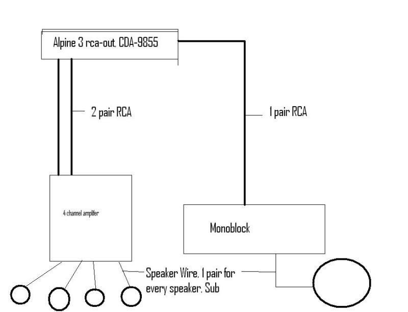

I have drawn a basic diagram below to clear my own doubts, please comment if it is correct or wrong.:adore:
u wont need Y cable if input of the sub amp accepts stereo RCA input.
Yap, if your monoblock amp has 2 RCA input, means that Left + Right side, then just use 1 pair of RCA from your Alpine HU Sub (L+R) to hook up direct to your monoblock amp (L+R), from your amp, should be able to set steareo (means use both L+R input and output to your subwoofer with either 1 Double Voice Coil or maybe 2 seperate subwoofer with Single Voice Coil) or mono (means use bridge mode so that you get more power to just 1 only subwoofer, but from L+R input still, you can connect it in series for 1 Double Voice Coil subwoofer or maybe 2 seperate subwoofer with Single Voice Coil, but still depends on how low impedence your monoblock amp can handle)
