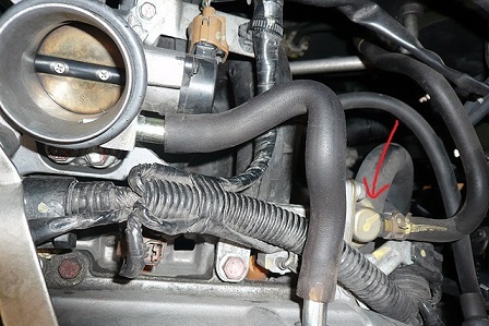

It seems that shops don't sell fuel filters and it is integrated into the pump. A quick google for the Sirion says thats the case also.
But after having a look, I saw something that could be a filter. Anyone know what it is?
