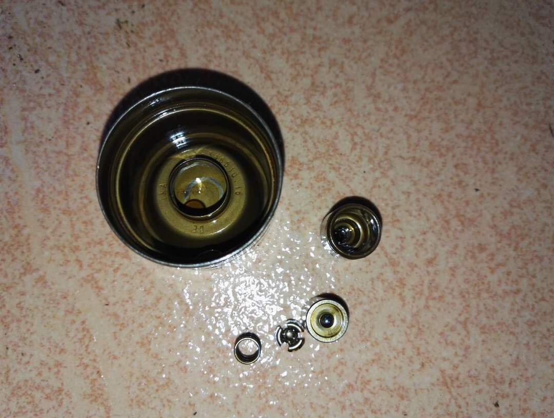

How about service those tappet? hihi:biggrin:
very tedious job.
one tappet cost rm30 only aftermarket mitsubishi.
rm70 is original tappet?
