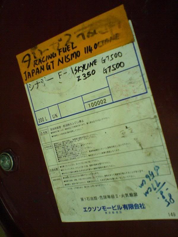

And if you think our current fuel prices are cheap, then you can try fill-up with this...
Bwahahahaa! :P
