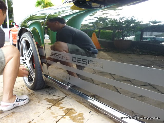

wash & onr on the whole car by Mr Seech

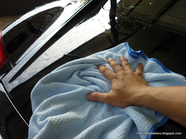

dry by optimum waffle towel - aka water magnet cloth..

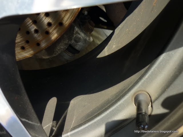

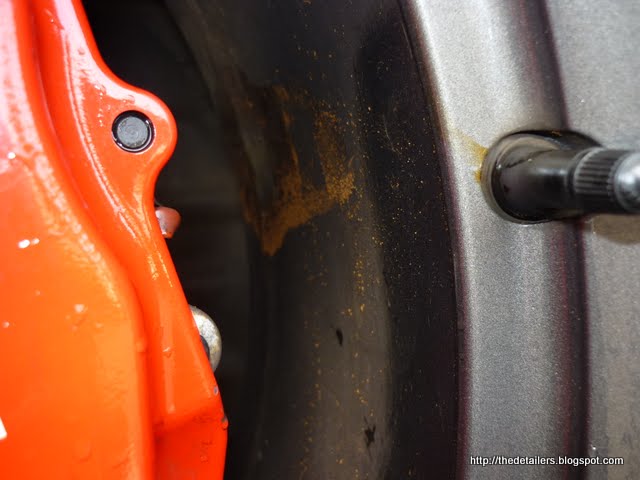

pic before

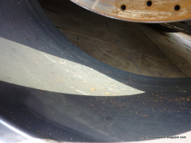

dirt grim dust brake dust tar plenty of contaminations
if these section of the car is not wash properly ....there is a transference of contamination to the rest of the car
as brake dust flew everywhere from there……u know where?

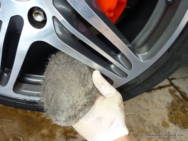

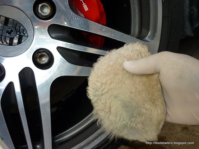

wool washing mitts...from my old ROB wool pad....sprayed with Optimum All cleaner
pics before
ta da...see what i collected

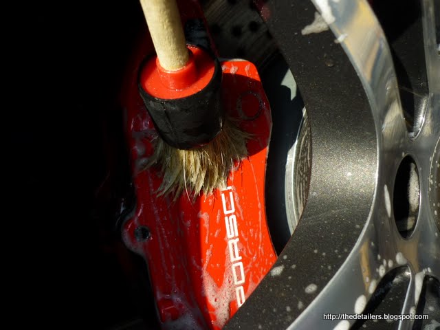

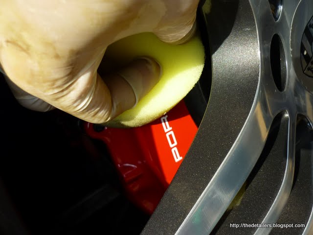

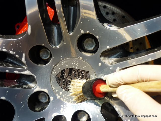

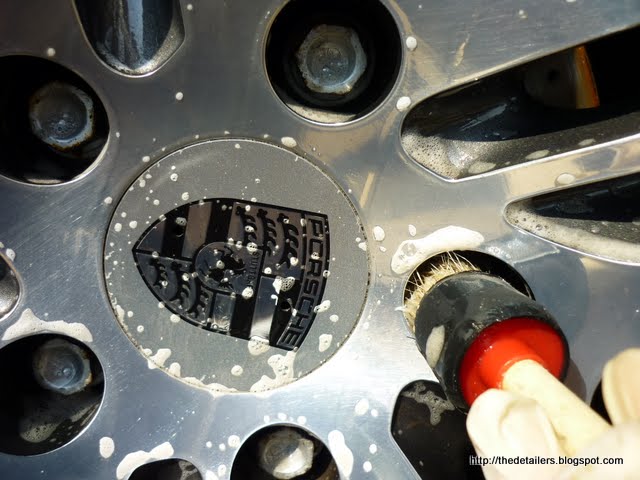

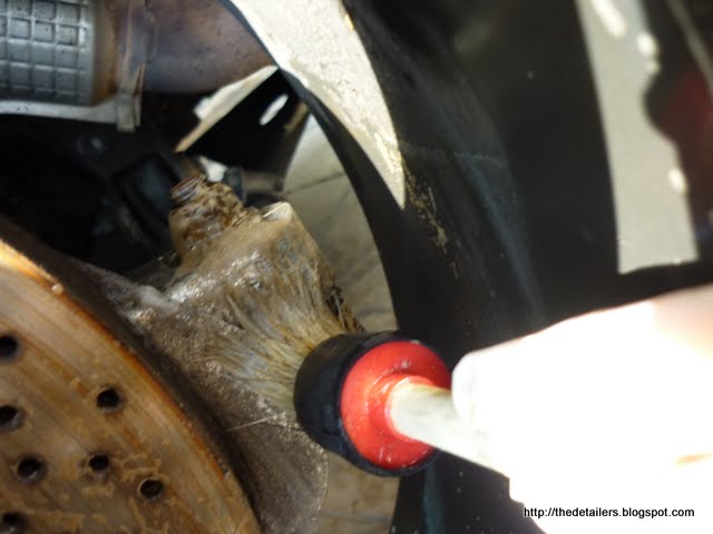

Optimum All cleaner agitating & brushing off with wheel brushes
brushing off with Optimum All cleaner

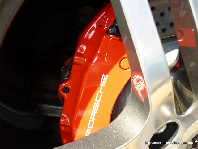

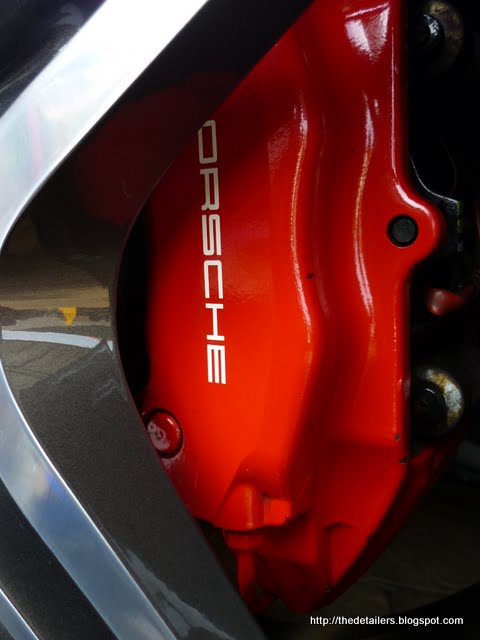

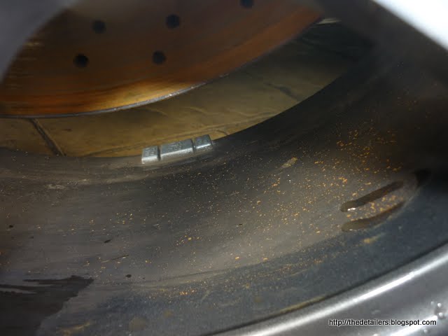

caked brake dust from the calipers
lower joints

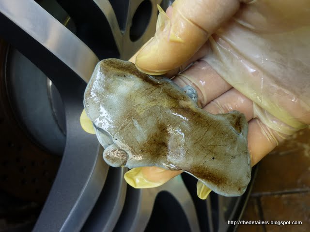

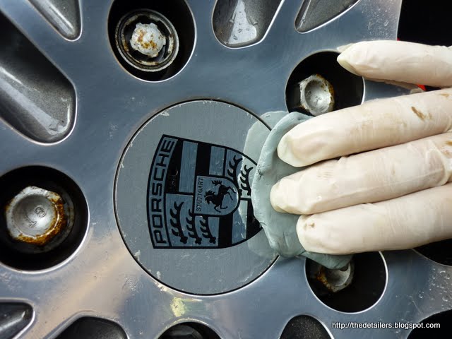

next clay & lube with ONR no rinse wash dilution of 2 ounce with 450 ml water
You wouldn’t want to see

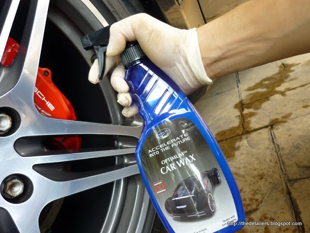

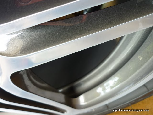

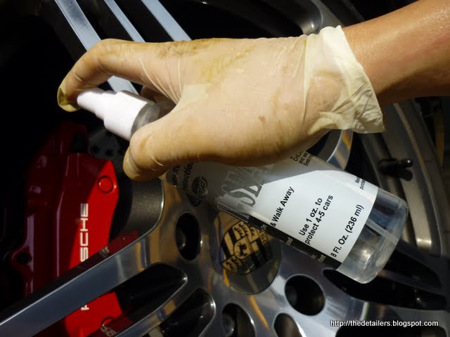

then optimum opti seal - sealing the rims prior waxing
Spray, buff off & walk away

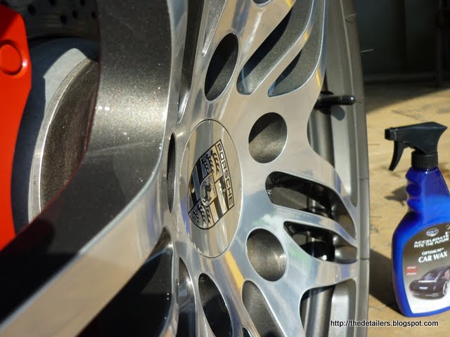

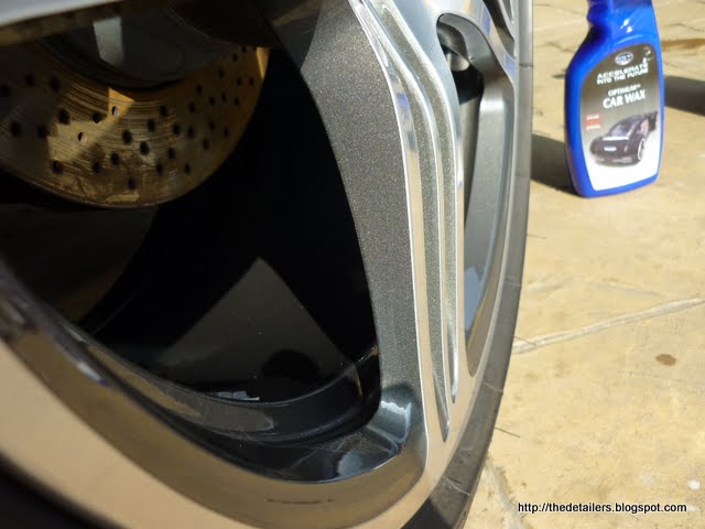

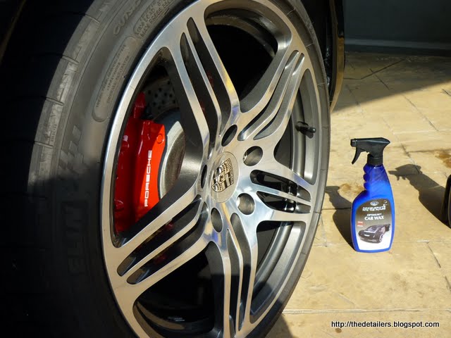

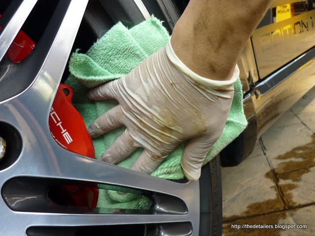

ready to be wax
wipe & buff off at the same time

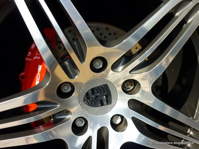

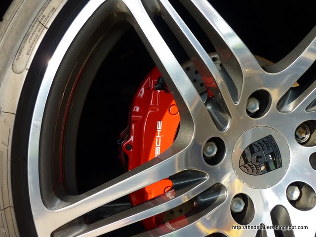

ta da
simple effortless washing & detailing

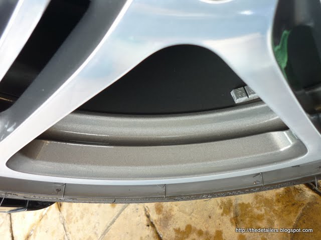

before
Ta da pics

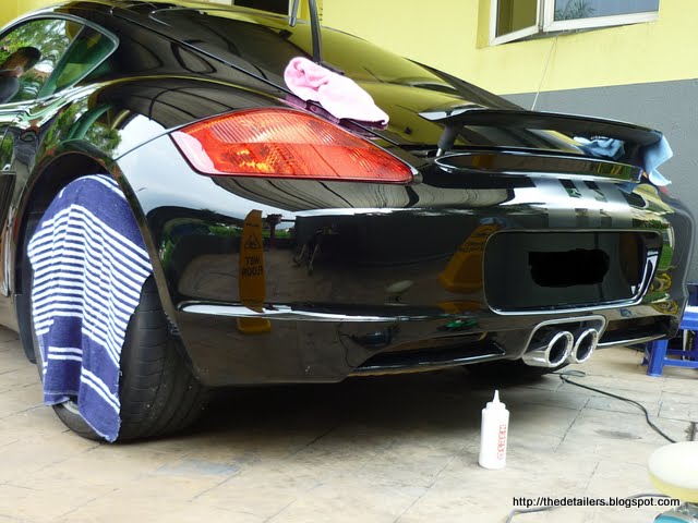

Then pls cover before heavy correction….hahahahahahahah
No la…protecting her from compound & residues
