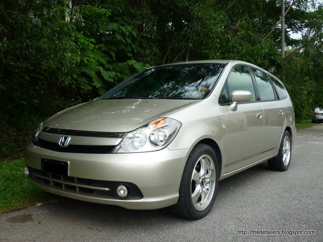

This is the 3rd ride full correction i did last raya on day 3
another good day for detailing & golf too
6 years CRV

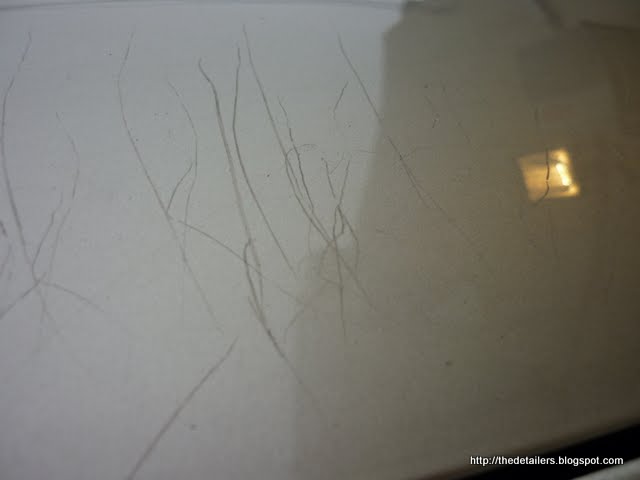

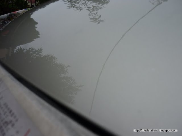

scratch before

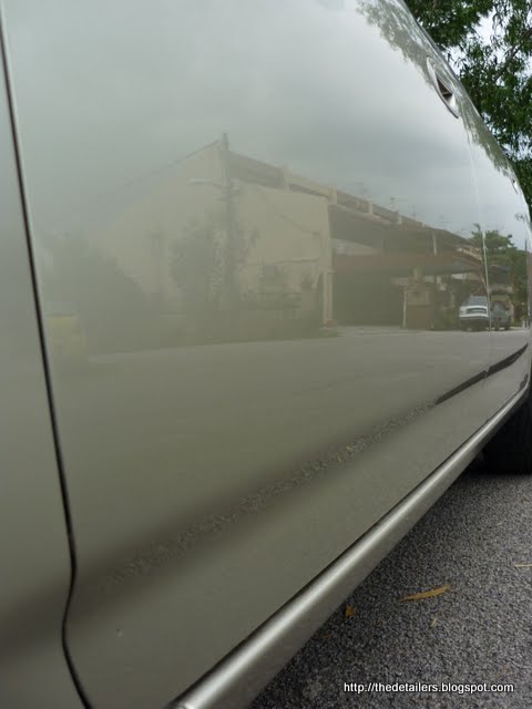

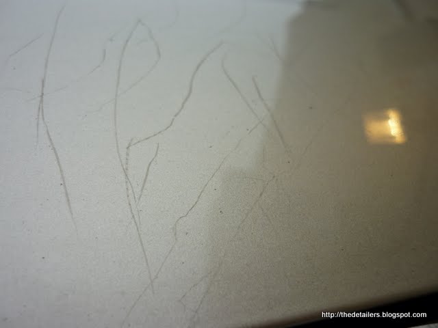

another teach u a lesson key scratched
more damage by his companion paws

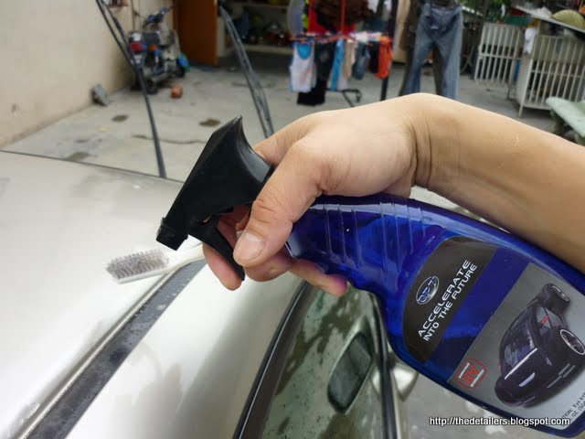

-O Power Clean - (1:1 used as degreaser, 3:1 to remove hard stains like algae, 5:1 paint cleaning & emblem cleaning, 8:1 door jams & stickers remover)

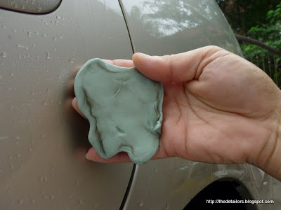

-Clay & ONR as QD for clay (2 ounces for 500 ml water)

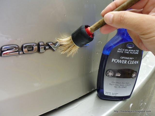

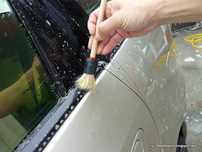

every emblem is carefully clean (agitating by Power Clean)
closer stains before
brushes off with soft bristle brushes
oxidized algae stained rubbers agitated by Power clean
more agitated pic
brushes off with again with soft bristle brushes again
more
roof rubber lining stains before
power clean sprayed on to agitate the algae
brushes off with Tooth brushes- a great recycle idea
another algae oxidized rubber stains
brush off by soft bristle brushes
ta da
cleaning hard to reach area
make easy by delicate tooth brush

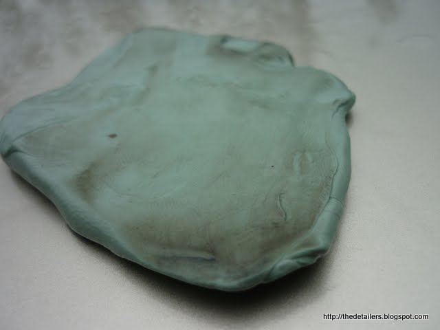

surface preparation works begin

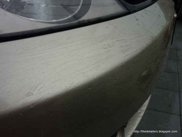

look at the surface contaminations picked up with clay
contaminations picked up side body area

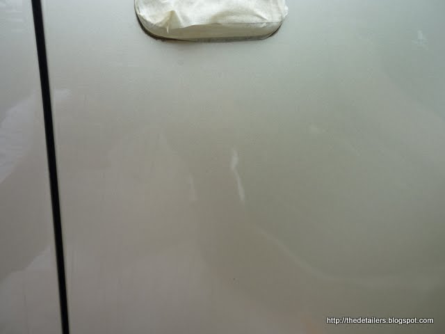

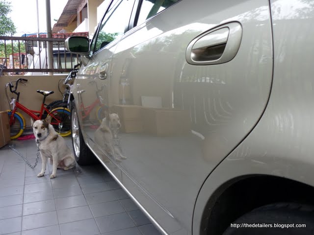

what do you do when your pet suppose to guard yr house damaged yr paint?
i) shoot him
ii) Sue him
iii) do both
vi) detail it

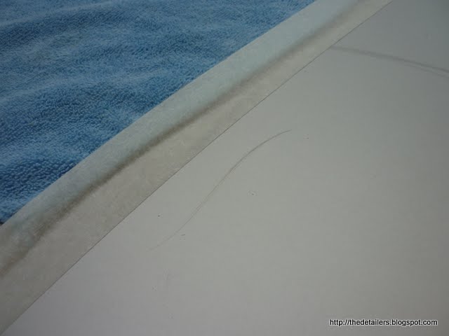

more visible damage by his companion paws

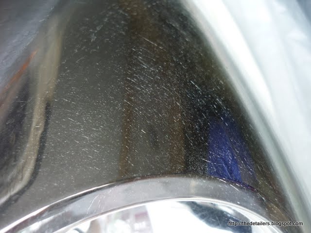

before
during surgery
on the engine hood
a 50/50% comparison before
before pic
the3 perfect 50/50% - on the line
50/50
50/50
after
special pad for special & timid narrow areas correction
Passenger door before
ta da

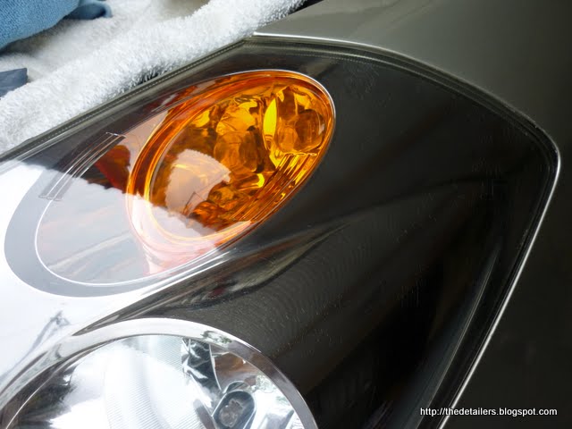

Another Impossible possible

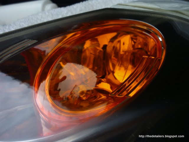

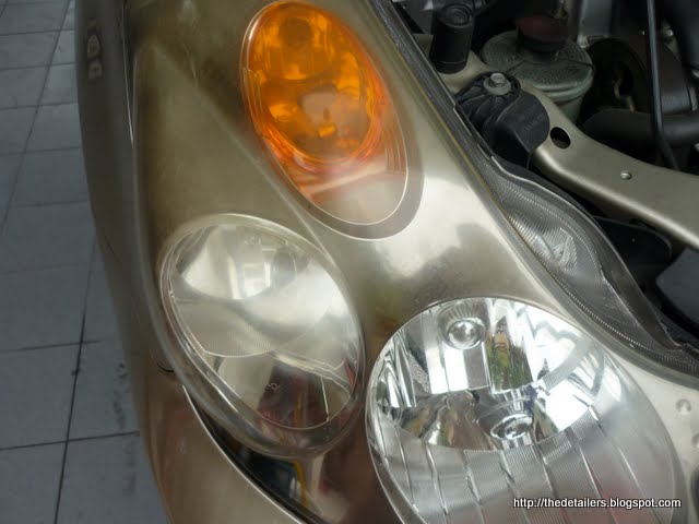

moving on damaged oxidised head lamp
closer pic
take a closer look
extreme close look.....cracks
side view

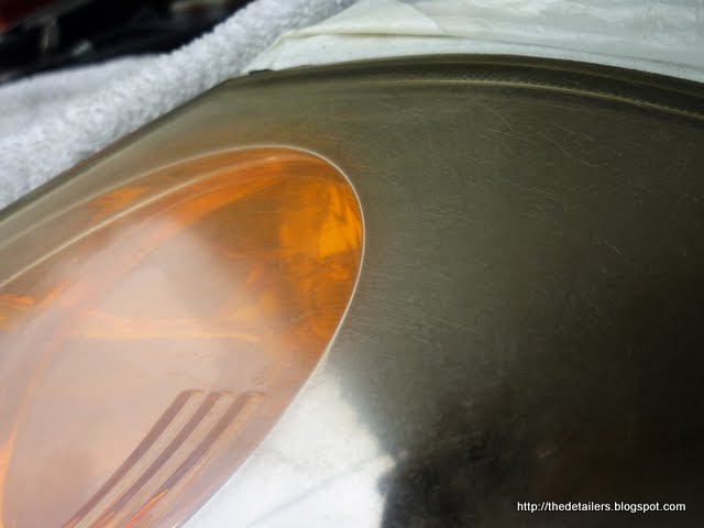

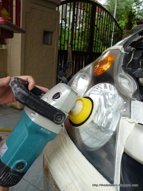

correction begins - sand down with 1000 grit sand paper - follow by 1200 grit & 1500 grits - ending with 2000 grits
although is fine but the deeper crack need to be levelled out by continues of 800 grit sand paper
continuous right side
sanding
sanded
close up cracks
continue sanding
the amount of oxidized plastic removed.....safety measure taken to protect unaffected area
sanded
sanding to help to levelled up the damaged
50/50%
after
before

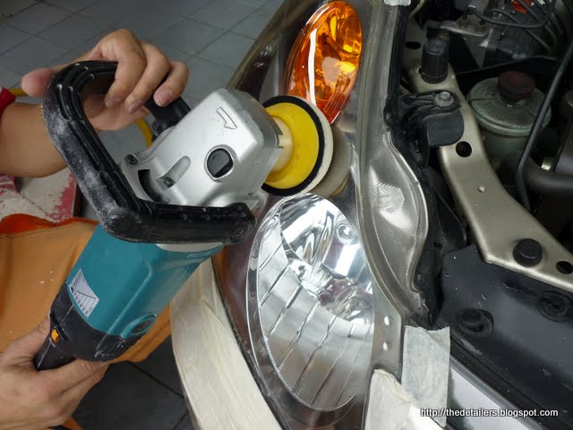

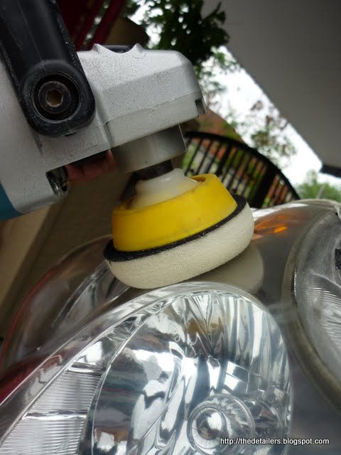

the prefect 3" pad
polished by the specially flown in pads from US lakers....Lake country
for it takes a cobbler to know his tools
ta da
tada
side view
now
extreme close up before & now
Now
http://lh3.ggpht.com/_RsduO4BD4FA/TJcF5XUa_hI/AAAAAAAALGM/kF2J9l0qUr8/s800/P1120104.JPG
remember before

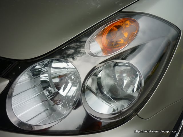

A restored head lamp
ta da
ta da
this head lamp is coated & protected by Opticoat (one time applications)
opps
solve one thing & created another
tape marks...but easily removed by Optimum power clean again
just before the rubber hits the road again
after paint correct, another quick ONR wash given - so easy & effective
if it is not of ONR - i would have given up mobile detailing - imagine the amount of mess & water required for each detailing - at times is 3-4 washes
ta da
the prefect moment of show & shine
side view
low view
top view
a restored head lamp
right side lamp
close up pic
elegantly yours
once was bruised by his best pal
now
reflection & gloss restored
remember before
now
remember before
50/50%
a beautiful moments ...happily ever after
remember this pic
tada

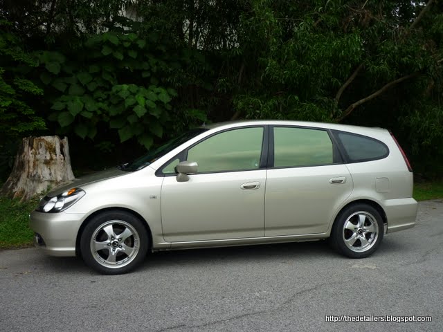

the right side of the ride

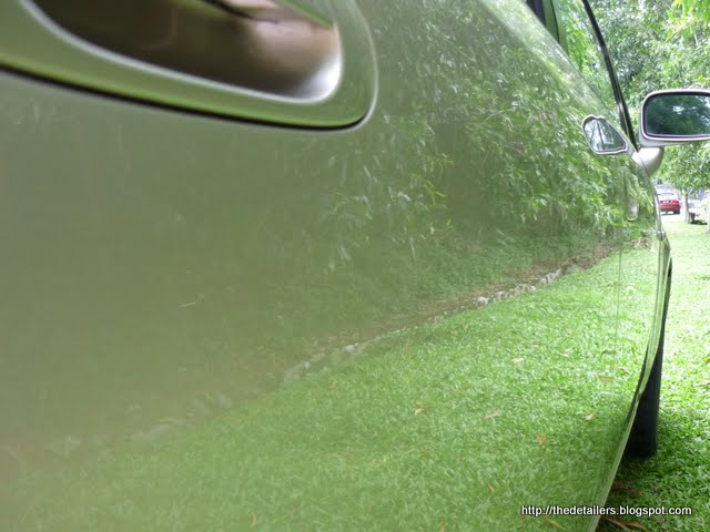

amazing on the headlamps...
and at first..the green scene picture on top was blurr wrong picture...now i know it was reflection :adore: :adore: :adore:

Bro, how was the scratches removed bro? Do enlight me, I might have missed out.

You do need a rotary
paint corrections
-Meguiars M105 & Lake country double side wool (fast & quick) (makita spread 1 & progress to speed 3)
-Level up by Optimum Hyper spray compound & Lake country double cutting pad (makita spread 1 & progress to speed 3)
-Paint glossed with Meguiars M205 & Meguiars soft bun polishing pad (makita spread 1 & progress to speed 3 & regress to speed 2 & finish with speed 1)

Bro, can you PM me how much is the O power clean..I think it would be useful on those rubber place and emblems...
Another thing. After wet sanding can I use any brand of polish or wax to make the headlight as good as new? I have a Meguiars Ultimate compound and I've used it to remove oxidized layer on headlights and it work really well...
Hi Buddy
I need to view yr lamp to comment - it is not just any brand & product
Eg Megs Ultimate compound is a consumer brand & it is not for rotary machine ...
& if your oxidation is too deep ...you could hardly done it by hand alone & it is not suitable to do it with machine
I use Optimum Hyper spray compound:wavey:
