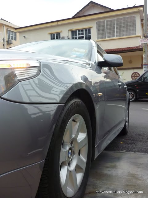

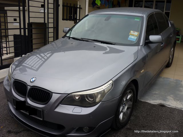

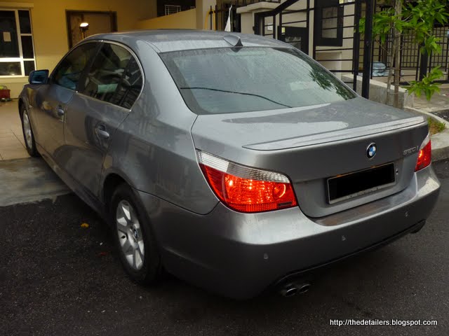

Pics before
Background

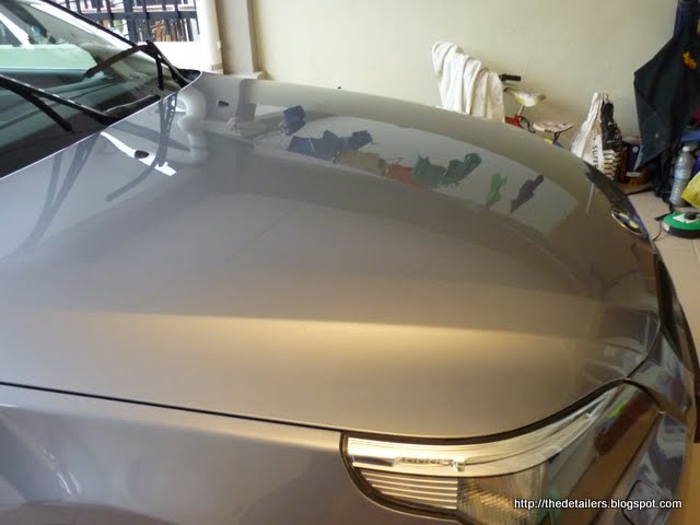

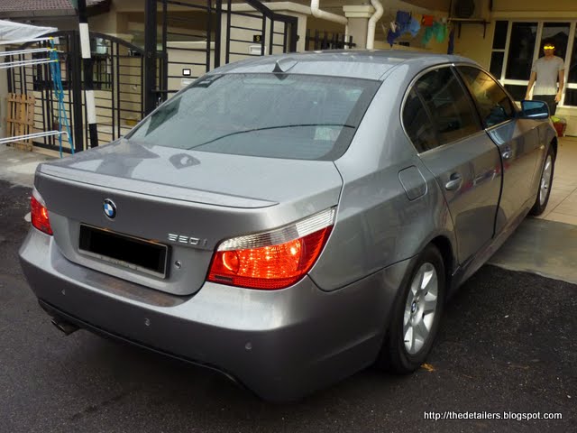

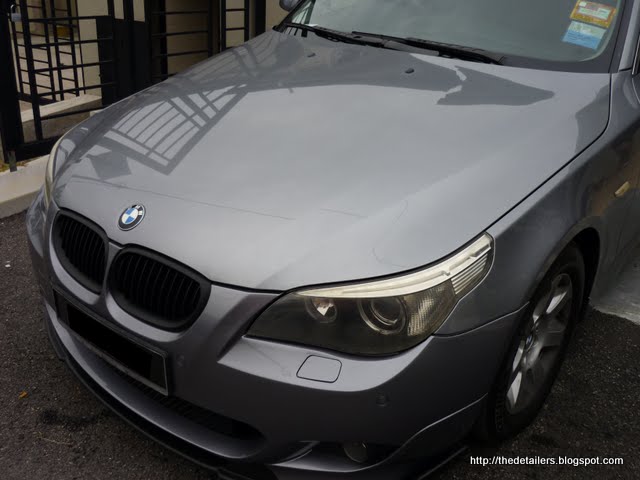

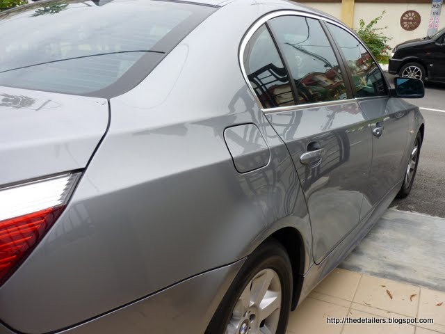

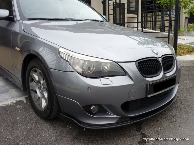

4 year old E60 UDM.... OEM paint... the colour looks dull & not much glossiness ...but one thing great about grey (a similarity with silver) they hide swirls well..... great looking paint even though it is not wash for weeks...dust hinernate well too

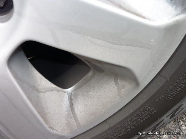

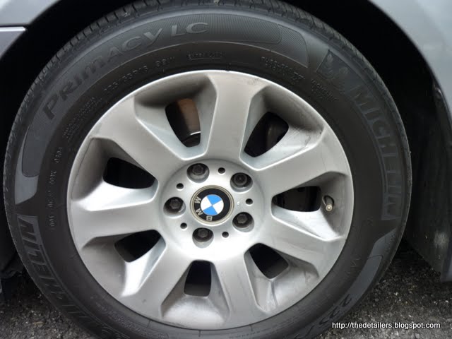

wheel before
close up wheel before

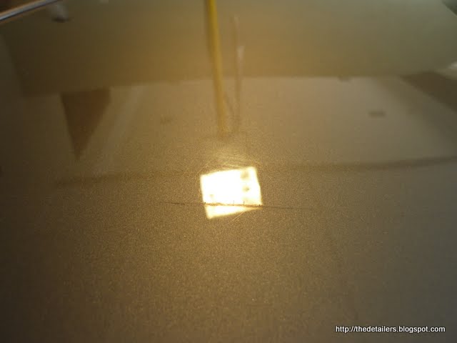

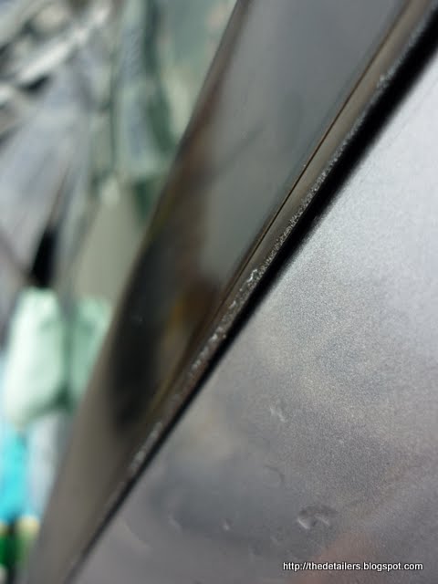

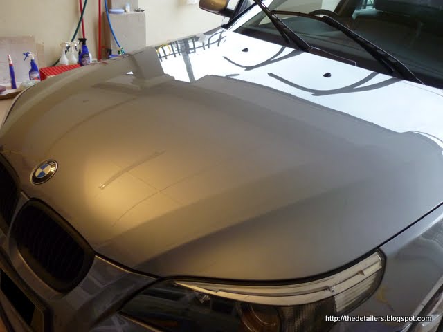

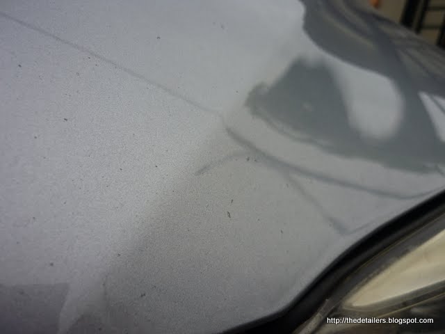

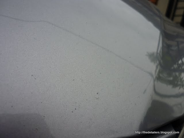

clos up pics......plenty of stone ships visible...on the hood

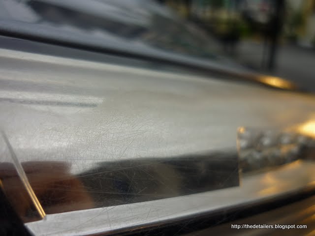

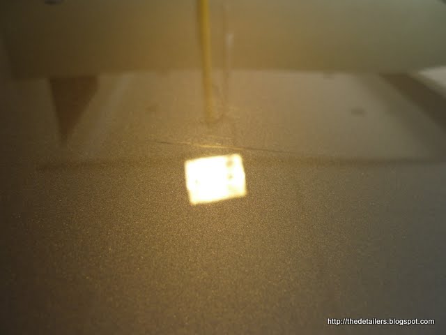

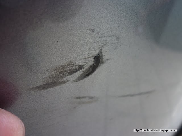

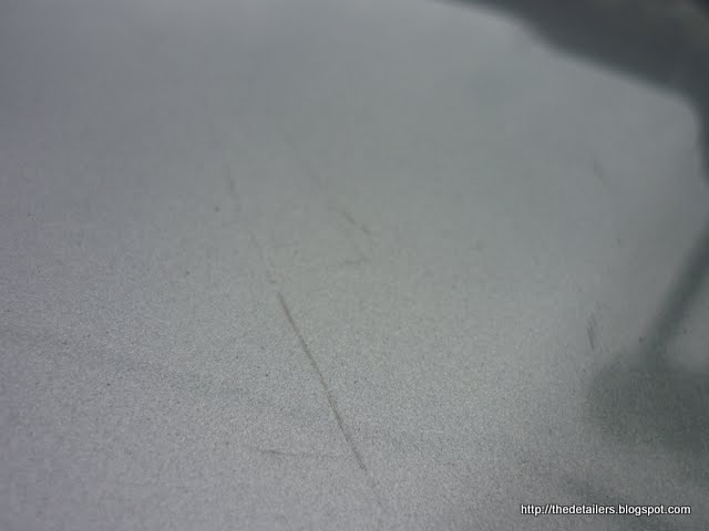

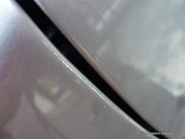

extreme close up pics of the hood...scratch

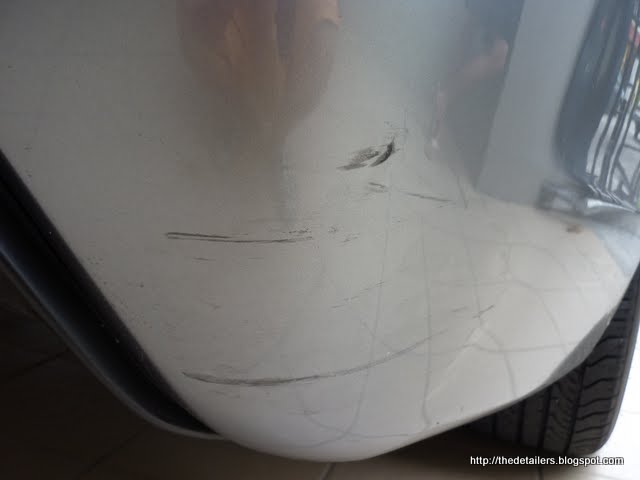

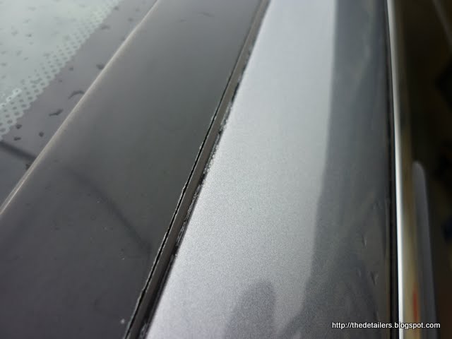

rear bumper ( some scratches owner request to be remove)
close up pics

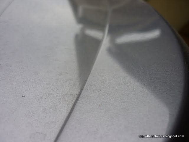

another TOGWT wax residue left behind by the previous detailer

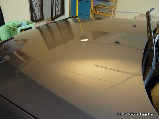

front hood
a arm
close up
ta da

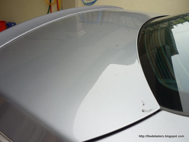

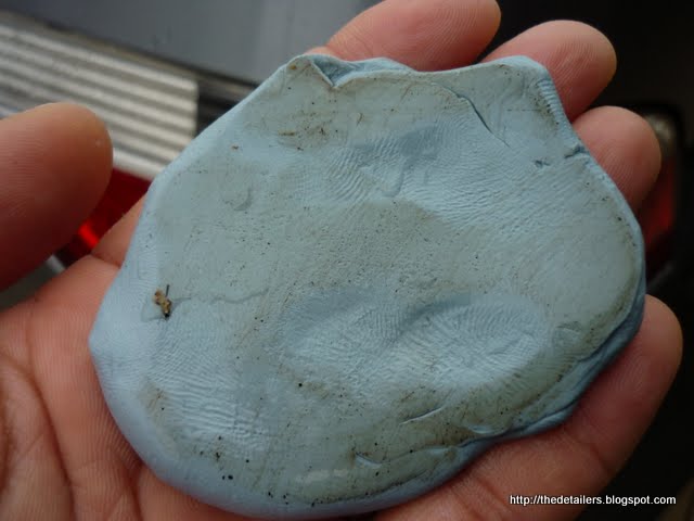

clay & ONR optimum no rinse wash as lubrications....it just picked up any previous stains or contamination....
it wouldnt scratch your paint while it remove the surface contaminations
clay pick up - contaminations from body
now a smooth looking car

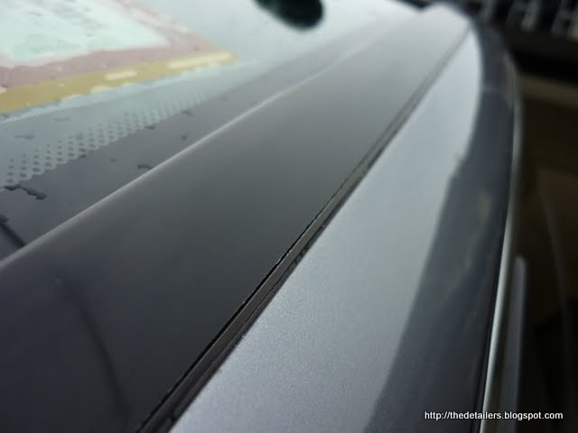

but is it a prefect one?????
still visible.....

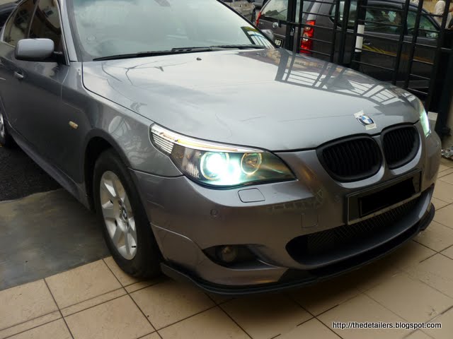

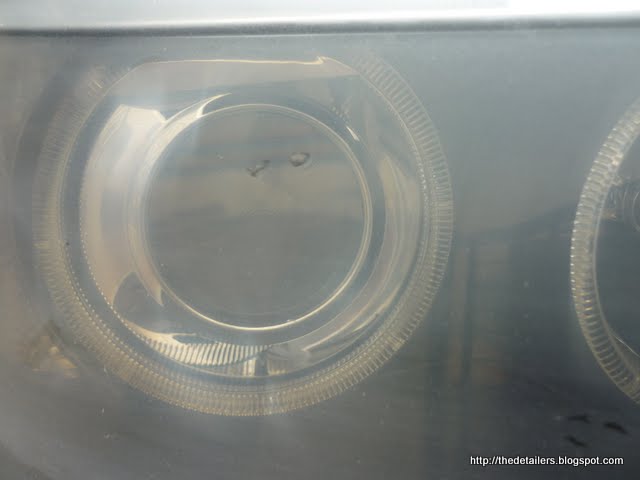

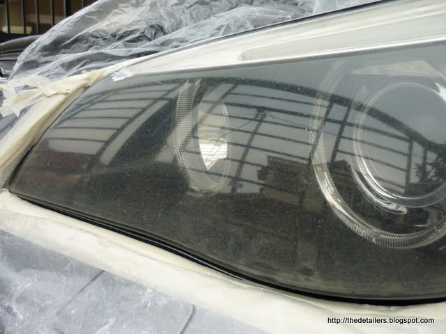

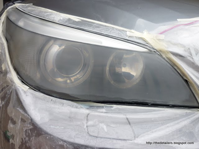

"Boss you must change la" - even superman cant help you - your head lamp is GONE.....Doomed.......we have taiwan make M5, local make...etcs
close up head lamp pic.....whhich of the 4 years old E60 does not have it aged

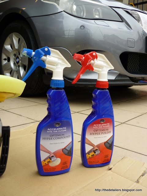

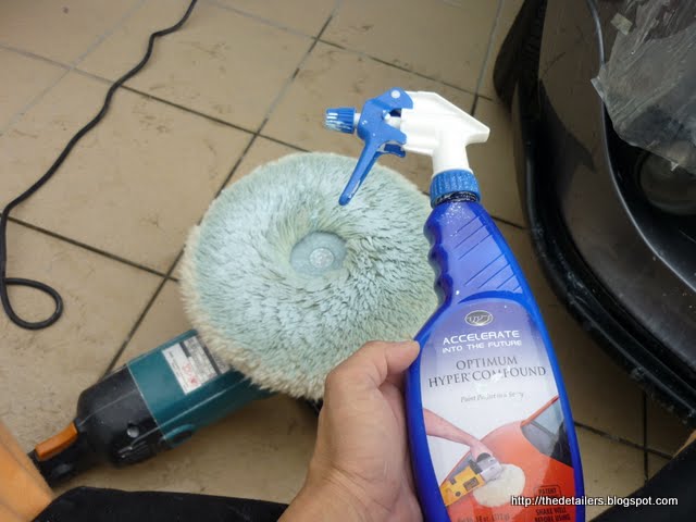

ladies & gentleman...the world 1st SPRAY compound & polish...the only one & only in Malaysia.....
Detailian Secrets juices :- (2 hours)
Alien Juice wash - 2 caps & 3 microfibers
Clay to pick up surface above contaminations - with alien juice with 2 caps into 500 ml H20 dispenser bottle as lube
Alien Juice wash again
______________________________________________________________________________________

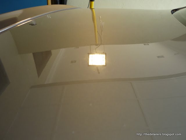

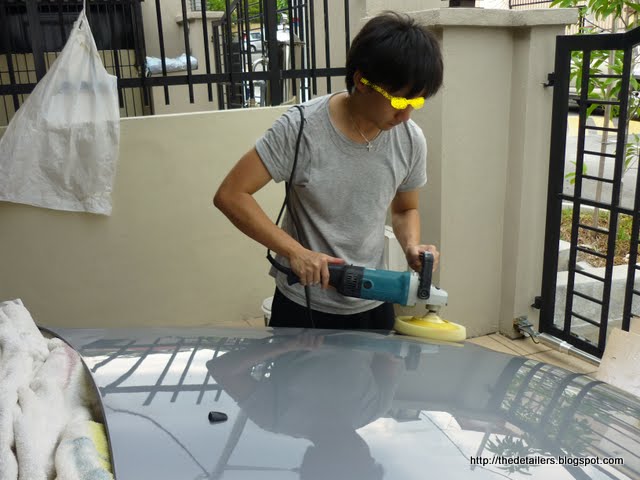

Paint corrections (all the way till finishing with rotary) :- (6 hours)

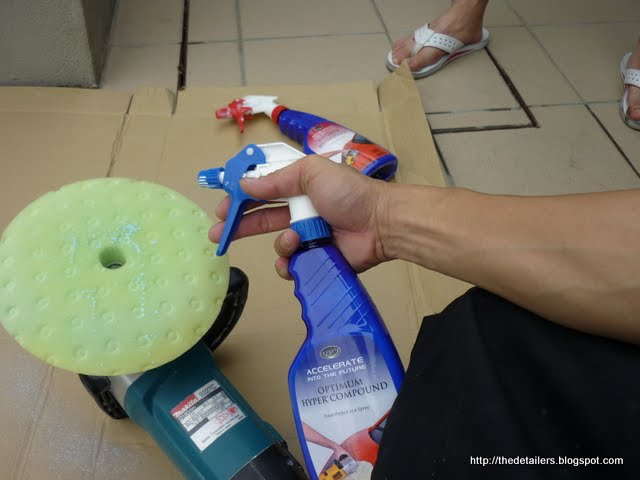

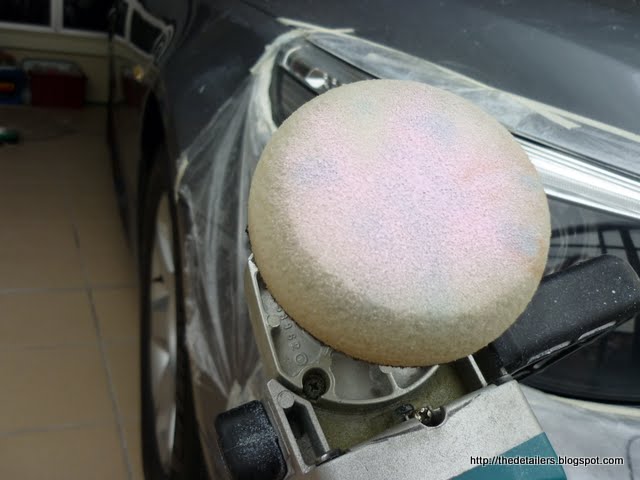

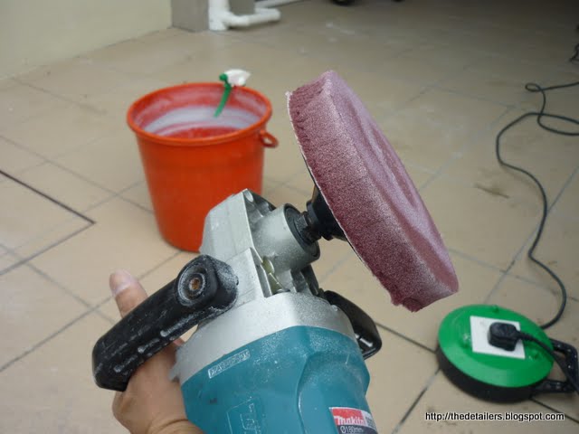

1) the phenomenal Hyper spray compound (1st in the world, another breakthrough products) with lake country double side wools - spreading with rotary speed 1, gradual increase to speed 2 & finishing with speed 3
stepping down to lake country CCS cutting pad - spreading with rotary speed 1, gradual increase to speed 2 & finishing with slower movements
paint perfection
2) another phenomenal Hyper spray polish (1st in the world, another breakthrough products) with Meguiars polishing pad

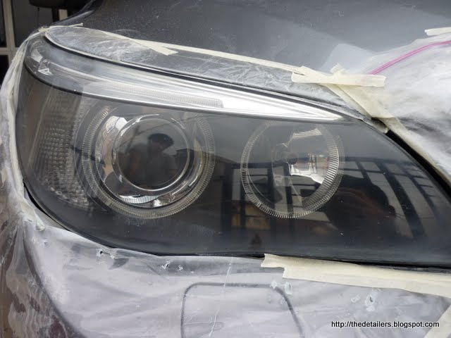

Out of the world request
Head lamb correction (2hour &45 minutes)
WET sanded - 1200 grit sand paper, 1500 grit sand paper & finishing off 2000 grit sand paper
correcting with
stepping down to Meguiars cutting pad (special 5 inch pad)- spreading with rotary speed 1, gradual increase to speed 2 & finishing with slower movements
perfected with
2) another phenomenal Hyper spray polish (1st in the world, another breakthrough products) with lake country 3 inch special polishing pad & 2 inch backing plate
Protected with
sealed for good with another world break through product call OPTI COAT

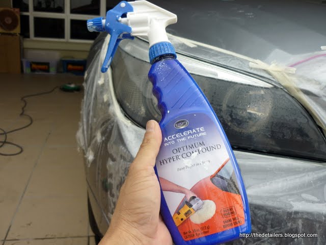

simple to use...spray on & get on to work
good cutting strength & long long working time & residue free...hardly seen any dust ..unlike my usual arsenal

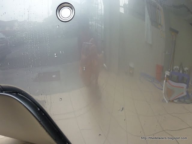

grey & silver (white as well) is the hardest of all three colours to fin fault & paint problem...
if you dont see ....does it mean not existing ????
so hard to find & harder to be captured by even digital lenses camera with sophisticated technology

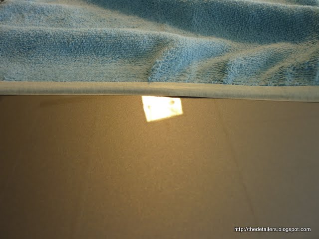

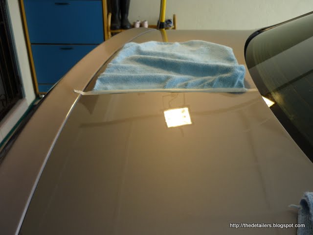

a 50/50% set

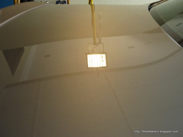

ta da
check this out
ta da
presenting to you
ta da

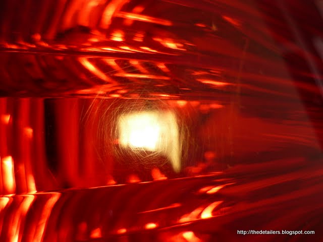

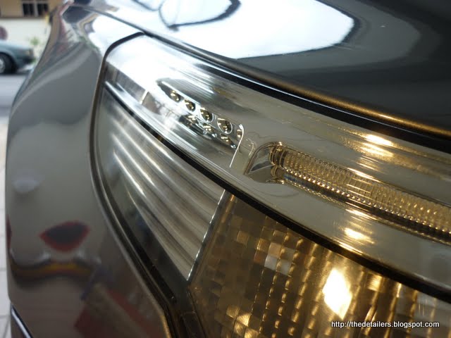

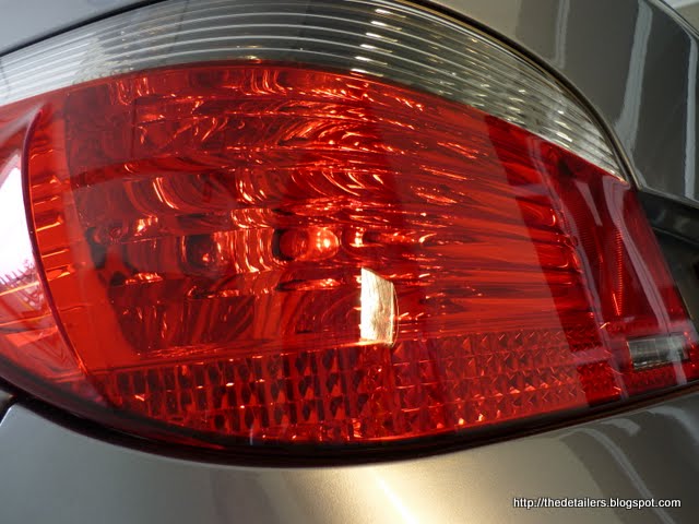

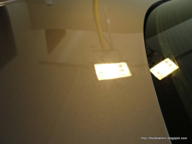

do know how badly is this car paint swirled or damaged by road side washing????

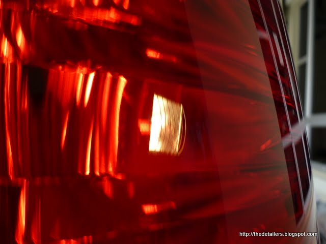

check out the rear brake light...the same damaged found all over the body

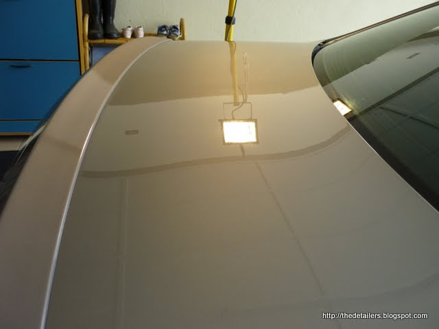

ta da
restored pics

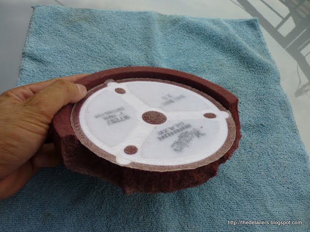

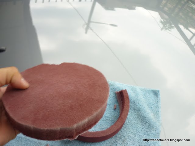

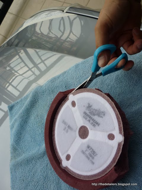

my newly cutting megs pad is torn...only after 3 cars

a brand new 5" pad...be optimistic...

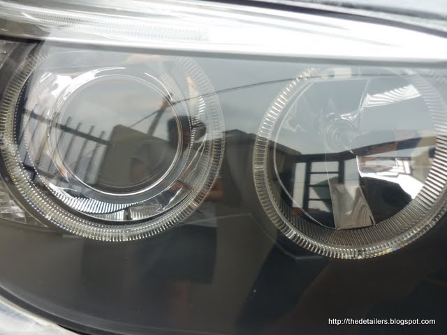

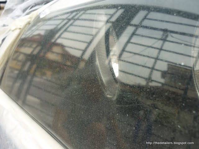

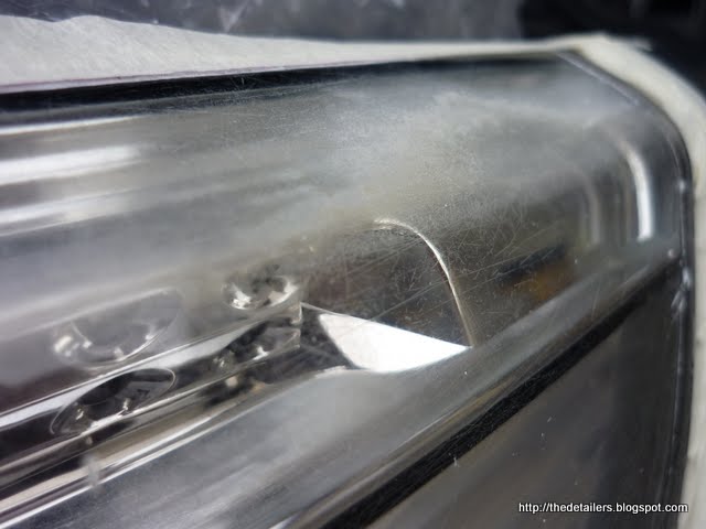

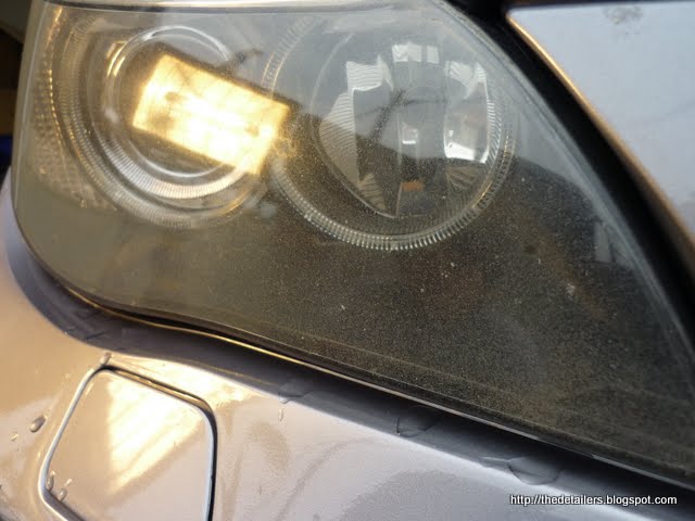

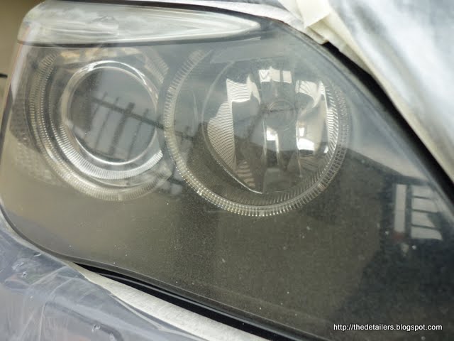

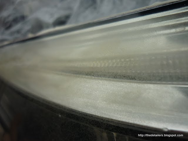

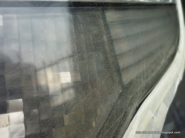

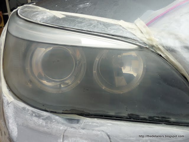

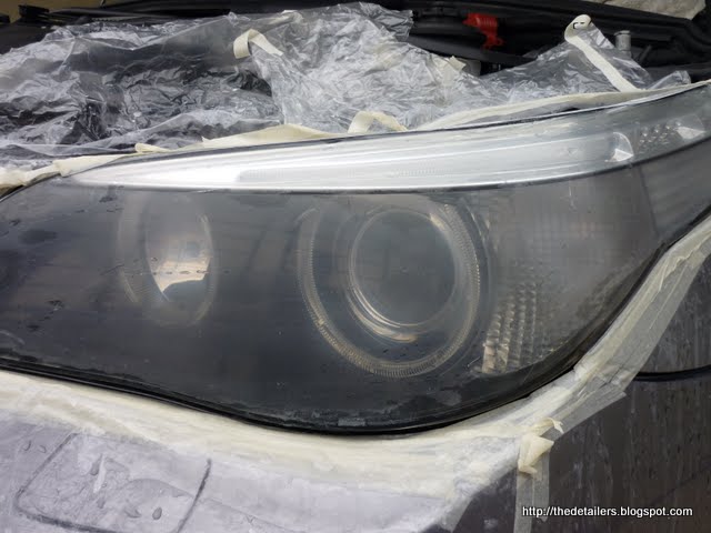

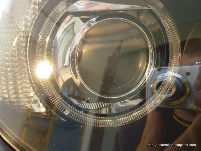

head lamp oxidized...close up pic
remember this
oxidized & blurred....sorry BOSS ..you mesti tukar(AKA have to replace it)
wow...this trigger my passion & once again...it takes an alien to do such a thing
There is no way, Must change a new one

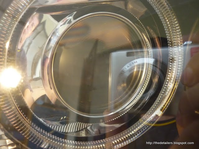

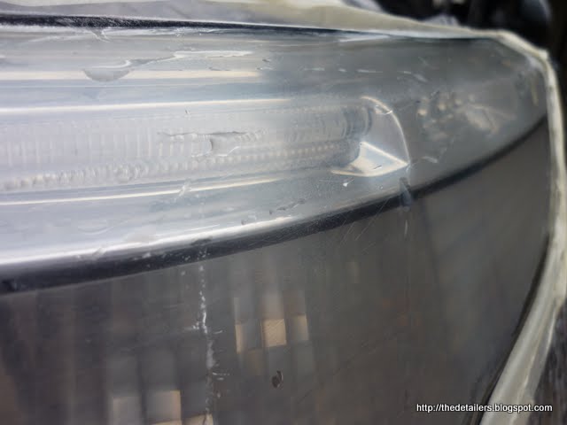

restoration begins
begin with
sanding down

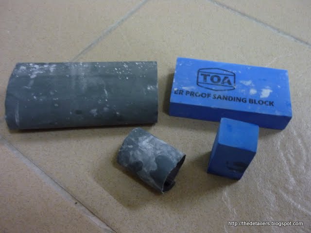

Tools required:-
ONR optimum no rinse wash as lube...
sand paper 1200, 1500 & 2000
sanding block...& special size sanding block
Optimum hyper polish
start with the lowest 1200 sand paper...corse sand paper...wet the surface with onr as lube.....inspect...resand
then wipe dry & inspect cont with 1500 sand paper onr as lube.....inspect...resand....use the smaller block for lower area & hard to reach area
then finish off 2000 grit sand paper onr as lube....inspect...resand

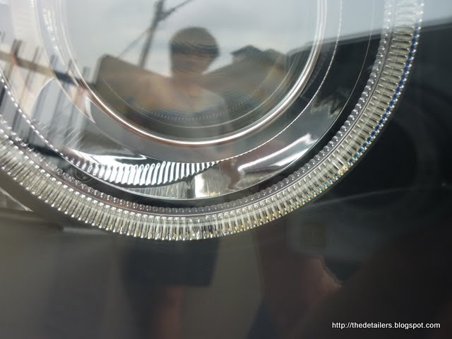

close up pics
my magic pportion
phenomenal - out of the world
compound with wool optimum spray hyper polish & start to spread with speed one then gradual to speed 3
continue with optimum spray hyper polish & special make 4' pad
good but is it prefect
the finish off with optimum hyper polish & LC 3" polish pad

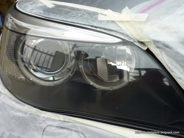

ladies & gentleman presenting you you what is dead....
ta da
close up pics
extreme close up p
you make me feel brand new
once upon a time it was like

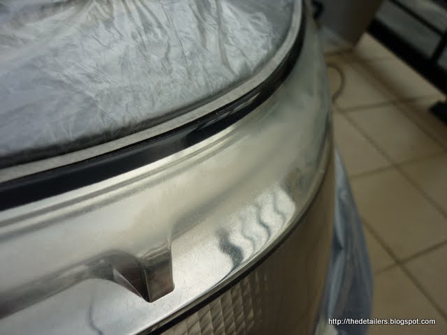

look at the close up pics, oxidised & later damaged by the road side car wash

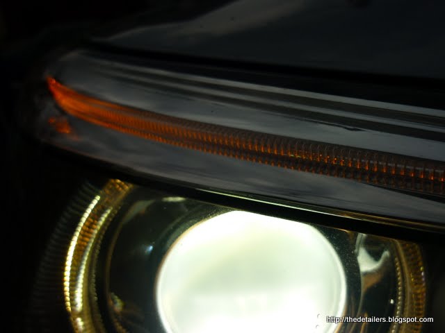

upper head lamp lid
another to the road of no return
tada
extreme close up & spot lighted pic
closer look
before pic
during the transformations
look at the restored lid now

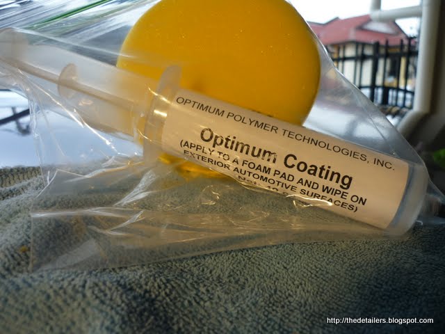

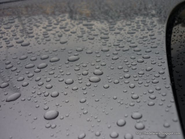

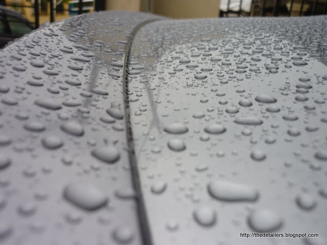

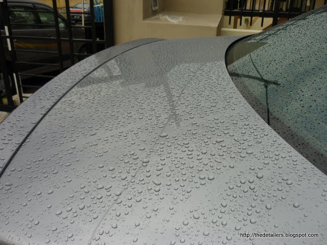

Now how do you hold this aging process....none other than the OPTI COATING IT...another great innovations coating
then rain came ..where protection of the paint is being tested
look at the rounded circular looking water beads, on a weel protected surface
and all it took us was 10 minute to seal it with opti seal
& 5 minutes waxing with optimum car wax

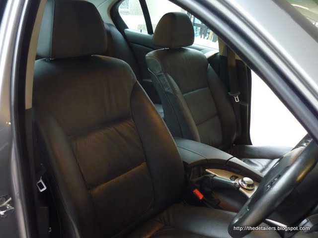

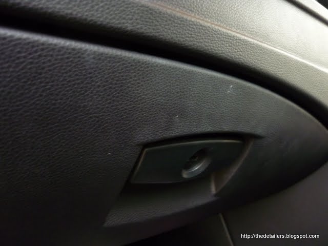

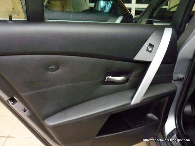

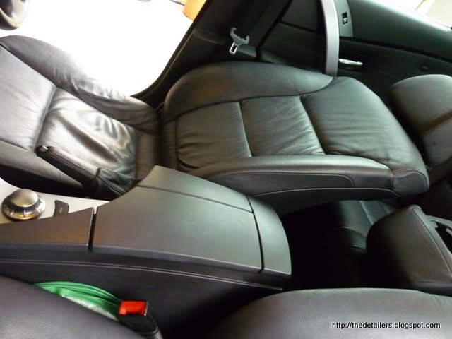

moving on the interior cleaning

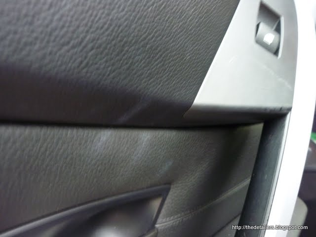

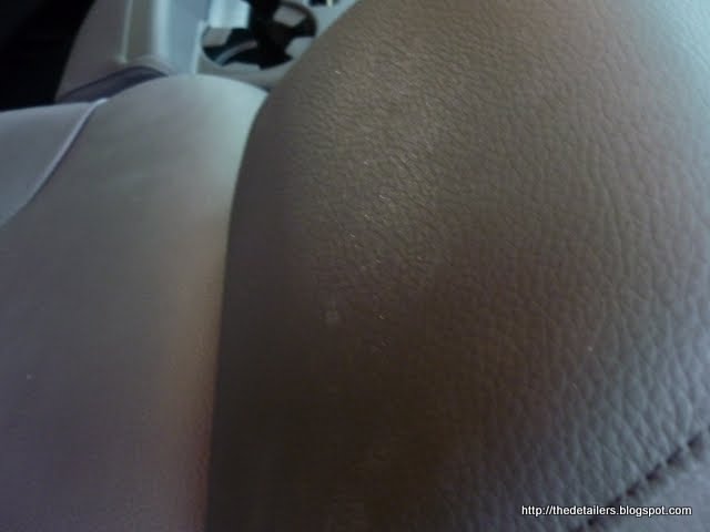

evidence of make up/ lotion/etcs...skin care lotion product residue on passenger seats..
more residue on the head rest
more on the door panel

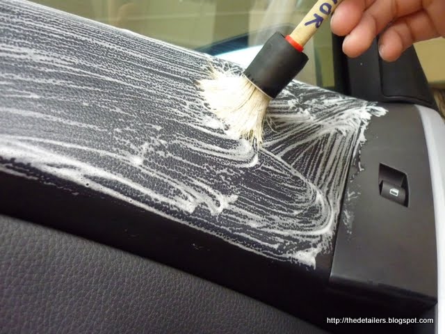

cleaning with optimum power clean
mixture of 1;5 water part & brushes with soft bristle brushes
ta da
later was protect by optimum leather p[rotectant plus
spray on & wipe off & walk away

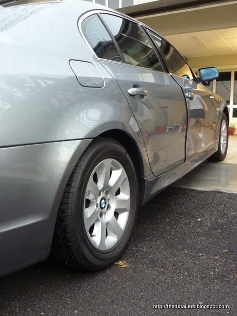

some pics after
before the rubber hits the road again
a bit more
more

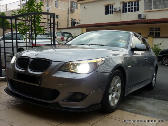

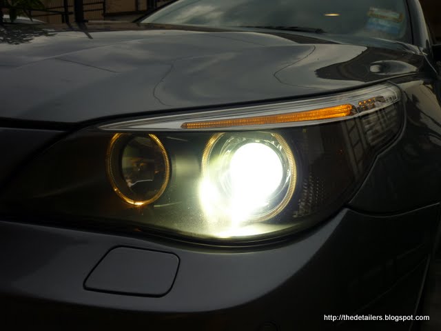

look at the young looking guy now

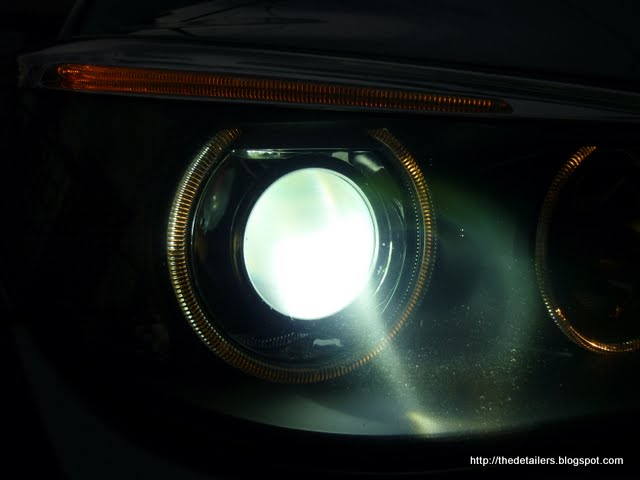

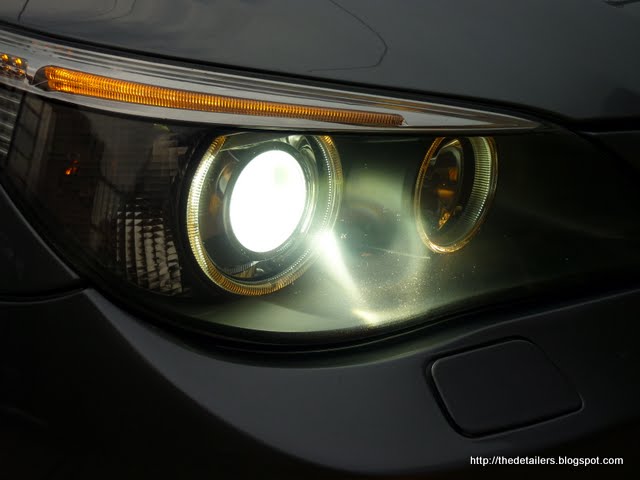

with restore head lamp
now the real test of fire
a restored head lamp
this would cost MYR 2600 per piece to replace
a further look
