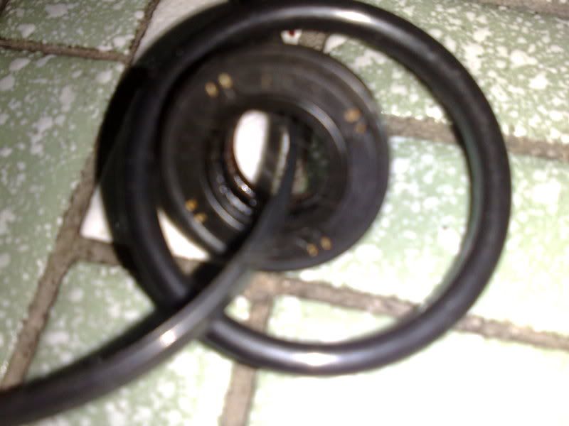

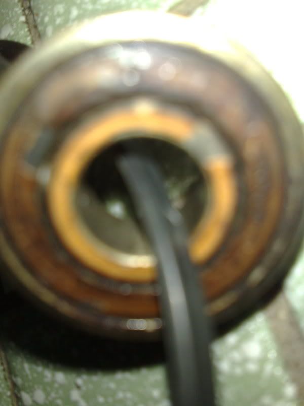

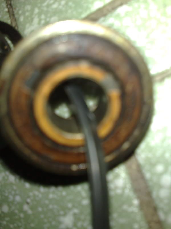

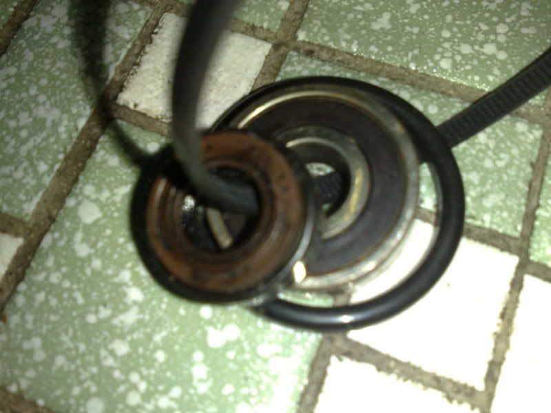

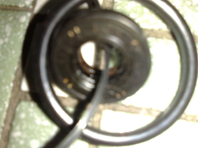

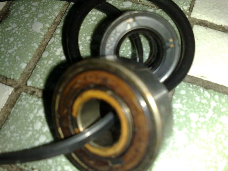

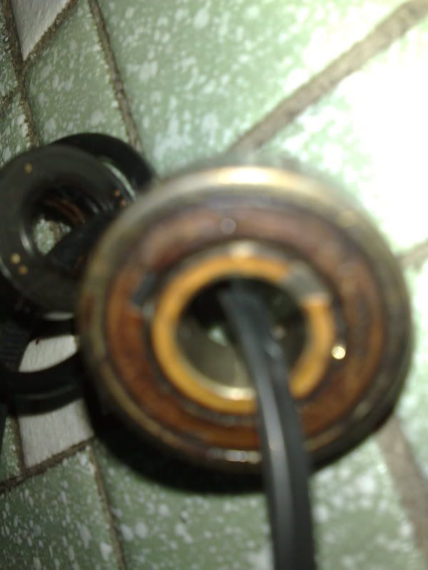

Updating : Change this three rascals and the leak will stop! (minus the cable/wire tie ok)
Looks like a bearing, a spring loaded oil seal and a O ring. So changing these 3 stuffs would solve the problem eh?
yup...
the inside oil seal...is the culprit...

Hey guys, it's totally up to you...
This is my 2nd distributor.. i used my own common sense and think that if you buy the whole part from halfcut and if the seals have not been changed before means it's 10 years old minimum (svt more la i suppose)...:hmmmm:
use back ur own and change seals will last longer (based on my engine, 13years!).. but guy's again, it's totally up to you la..
this was my preference after buying another distributor and it leaked...same like the a/c comp..
it's falling apart!!!!!:bawling:
