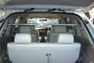

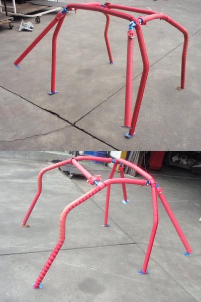

This one oso monkey + bar
With this bar in car, we'll have to wear a monkey suit , waaaaahahaha!:biggrin::biggrin:
Pls guess urself which one the correct one ...

was that monkey bar actually part of rollcage in the middle section of a car???? (on open top car they call roll-hoop???)
like this on TT_covertible>> http://en.wikipedia.org/wiki/File:Audi.tt.arp.750pix.jpg
and on this caterham >> http://en.wikipedia.org/wiki/File:Esther-rear.jpg
is it the bar u were mention of??
the third picture rite??? :adore::adore::adore:
i think its the caterham type...but isnt that also called a roll-cage? those at the bottom of the cabin which is across the bottom of the B-pillar i tot is called cabin bar?
if caterham type sure it was rollcage...
but in cda posted img...the 3rd pict. sure explain what was monkey bar meant by TS.....
