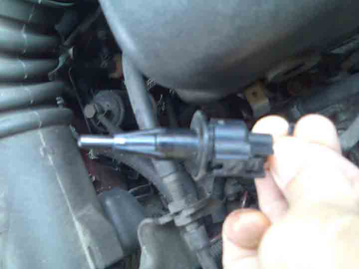

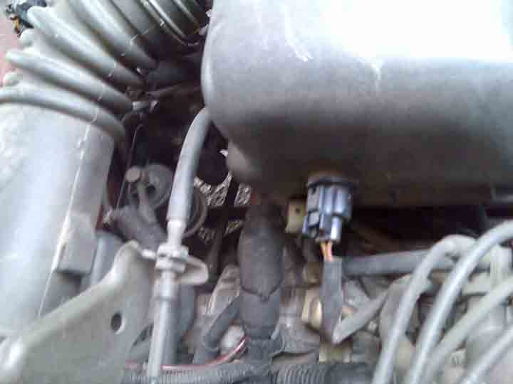

Hi Sifoo GT Auto
AS promised, here are 2 pix on how the 4AFE air sensor look like... is it the same as the Vios as u mentioned?

in ur case bro,it's easy lar.u can drill a hole on a pipe n glue the sensor
to the pipe using silicone.it's not the same as vios.vios sensor use 2 screw
to secure it on the air box.
