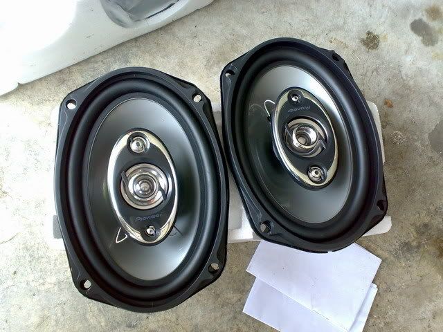

anyway, updated something jz now... kekeke... nothing special in fact...
3-way 6 x 9 speakers are good value speakers, u get decent sound, plus strong mid-bass, gud maaa
