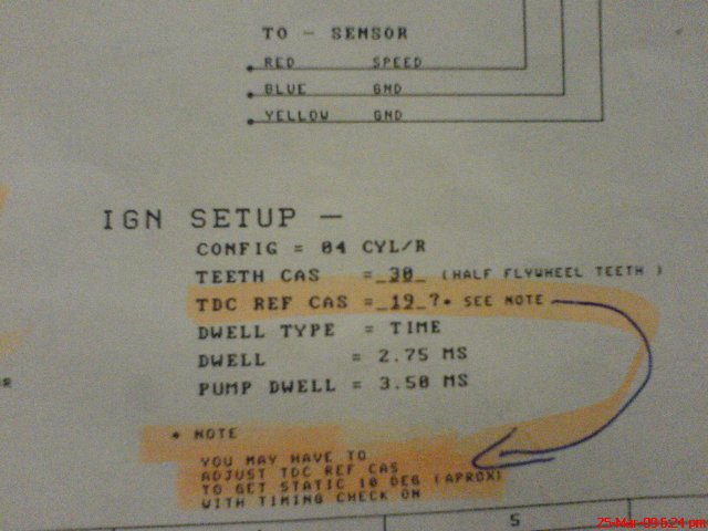

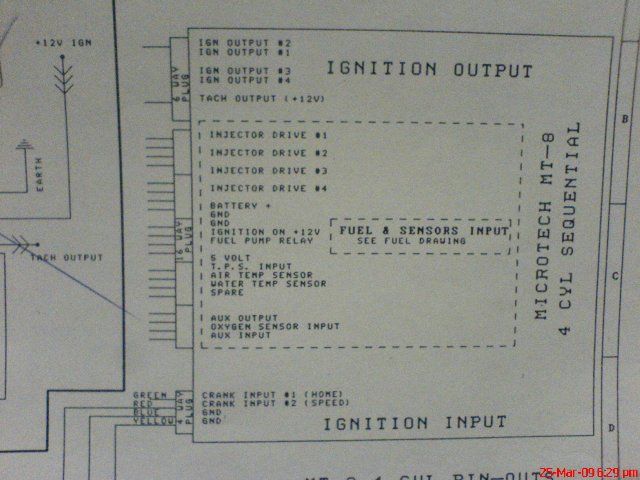

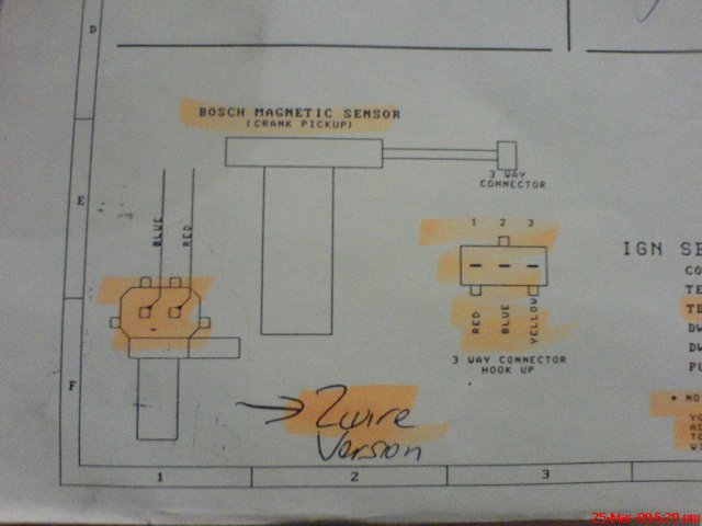

Hi...Bro Vteckiller,thank for reply me.
I try to connect the wire ,but no respons to crank signal,the Microtech ign input just wan use 3 wire only.1 red(speed),1 blue(gnd),1 yellow(gnd).I don Know how to connect....
The ign drawing like below....

very easy la....
here is how its done..
microtech harness----------------distributor harness
black-------------------------------big black
red --------------------------------red
green------------------------------small black
white------------------------------white
just follow this u will surely be right! unless u have accidenly burn the ecu..then it wont start.all the best :)
