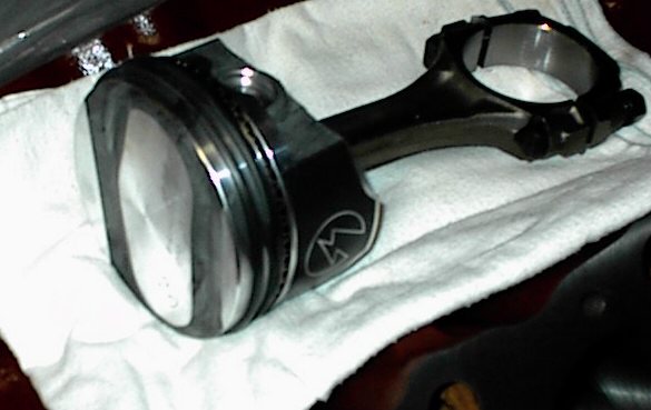

Here is some technical spec and piston photo. Hope can help you.

mines998: its for a kia spectra engine :). btw, the pic u attached, is it a set of custom JE Pistons? How much did u buy it? including custom conrods?
^pomen_GTR^: although a 1zz's bore might be a little bit too much for my first bore up, I will still consider ur recommendation as one of my options.. thanks..
Ya is a custom made piston for 6A12TT engine 6pcs a set I think around 4k including freight cost. Con rod is made by other shop about 4k aswell. Need to wait for 2 month and send yr original parts to them for fabricate.
