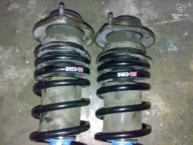

one of my foreman recommends me to go for APM absorber set..with rate adjustable spring..below 1k-(all 4)
sifu's any better recommendation?wat the spring rate should be??

not sure.... but most otai swear wif RS*R springs + Kayaba New SR abs combo... something like this http://www.mudah.my/Absober-RSR-L2s-3876610.htm
During my NA days, I used the GAB SL Series Semi adj.... trade it in to funds my engine swap... now currently using standard L5 springs and abs...
not bad..kayaba sr absorber and rs-r spring..wonder wat the spring rate might be??
will contact the owner asap
shop around bro... that's only an example... maybe can get lower still? :hmmmm:
p/s: met wif a seller selling FGK single outlet version for my car... he sez kayaba sr absorber and rs-r spring are good if 2 max inside.. more than that the ride/handling deteriorates....
dunno la... its his experience :hmmmm:
i didnt get u.wat u mean by max inside..:stupid:
so comfort is not there if u go aft those brands??
how bout APM,GAB,Kayaba rs-pro??
any comment bro??
any comment bro??
i also dunno myself... before i swore by GAB made in mesia type SA but that considered a lil hardcore oso for me...
now running L5 std springs and abs all around... comfort is there but on the highway got bumping macam kuda....
was considering this new product on the block... plan to change once my abs kong
