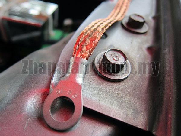

the copper part dunno wat u call it.
This one?
