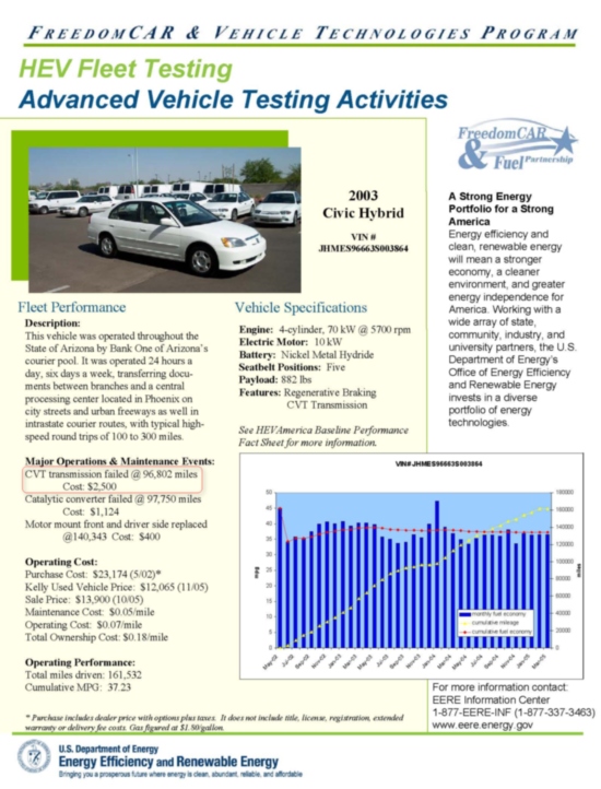

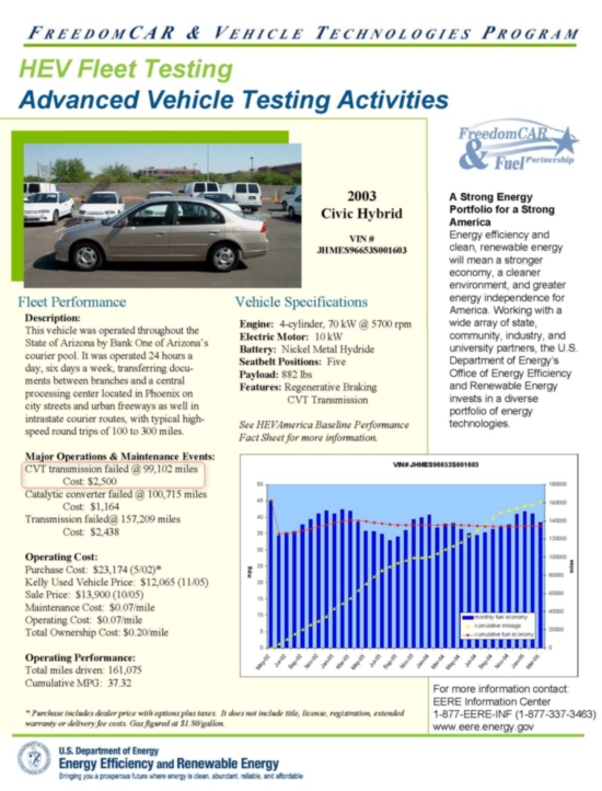

2003 Honda Civic Hybrid:
They are testing 4 Civic hybrids, all with CVT transmissions.
  • Two of the four have CVT tranny failures.
  • VIN 3864 has 161k miles, and had a transmission failure at 97k.
  • VIN 1603 has 161k miles as well, and had a transmission failure at 99k miles, and again at 157k miles ($2,500 to replace).
VIN 3864 Fact Sheet
VIN 1603 Fact Sheet
2003 Honda Civic Hybrid: http://ev.inel.gov/pdf/hev/honda_civic_fact_sheet3864.pdf; http://ev.inel.gov/pdf/hev/fact_sheet1603.pdf.
p/s: Not sure whether the new Civic hybrid is using the same CVT as in 2003 model year. Please confirm yourself.

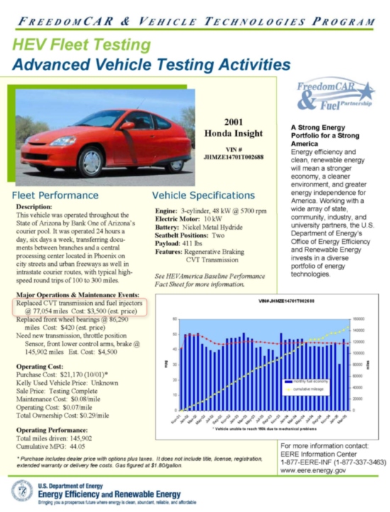

2001 Honda Insight:
They are testing 6 Insights, all with CVT transmissions
  • Two of them have CVT tranny failures.
  • VIN 2163 had a transmission failure at 77k miles.
  • VIN 2688 had a transmission failure at 90k miles.

VIN 2688 Fact Sheet
2001 Honda Insight: http://ev.inel.gov/pdf/hev/fact_sheet2163.pdf; http://ev.inel.gov/pdf/hev/fact_sheet2688.pdf.
