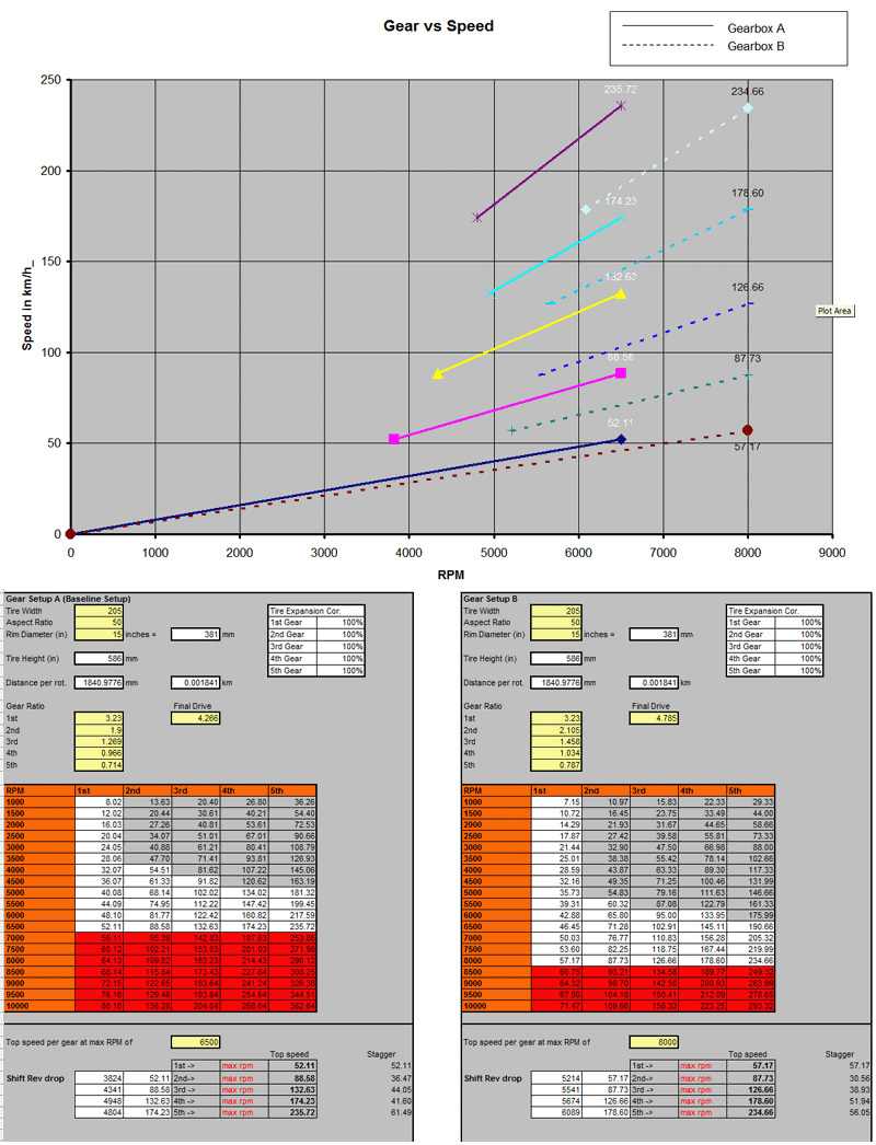

Example of close ratio for a 6500 rpm engine and 8000rpm engine.
It might seem the ratios are nearly the same, but if you rev gearbox A up to 8000 @ 5th gear, you can hit 290km/h!! Thats amazing, but only up to the point you realise "how long" the road you will need, and "how long" the time it will take for you to reach that. hahaha.
Most close ratio gearbox (since they were designed for the track) can't even hit 240km/h at all, stock Y21 can, but it takes AGES! hahaha.
So in summary, if you put in ratio for gearbox A in your 8000rpm engine, you will feel like it's a wide ratio. If you plonk in gearbox B in your 6500rpm engine (that makes the same power) you'd be shifting like a madman, because it's super short, so gearbox B becomes a super close ratio transmission in the 6500rpm engine.
There's no preset definition of a close ratio gearing.. if you take a close ratio gearing from a 6500rpm engine, then it will be a wide ratio for a 8000rpm B16A. It's just not the numbers, but rather the gear stagger.. how much speed does each gearing give you? As you can see on the chart, the more speed you can gain in one gear, the 'wider' you can consider the ratio.. so it's dependent on RPM as well, because gearbox A can be considered close ratio, if it's in the 6500rpm engine.
Usually gear one and two is a bit close (at least for honda transmission), so it's hard to say that it's a close-ratio or not with just two gears.
Confused yet? I was at first too.. lol.
The chart above is useful because you can gauge how 'heavy' the gear is by it's steepness.. the more steep it is, the more torque you will need. The more closer it is to being horizontal, the less torque you will need. But you really need to calculate the incline if you're really fickle about numbers. Notice the incline angle for the two gearboxes are nearly the same, so they're both close ratio for their specific engines.
Sad to say, this is not even the half of it.. There's also the subject of the torque curve and 'usable power' that relates to gearing... but that's another story.
