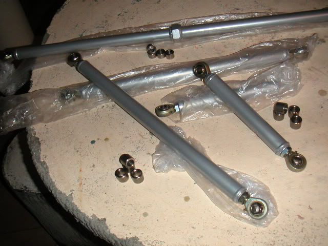

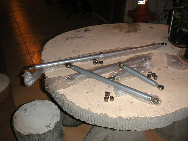

here's some pics of the Panhard Rods i made.
it's powder epoxy-coated silver.
material specs:
tubing:
carbon-steel SEAMLESS tube, 1" OD, 2.3mm thick. (OE spec)
threaded ends:
machined mild steel, M12 x 1.5 threads, MiG-welded to tubing.
finishing:
lathe machined, finished with epoxy-powder coated. (silver)

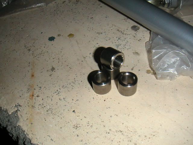

comes with stainless steel (for durablity) collars.

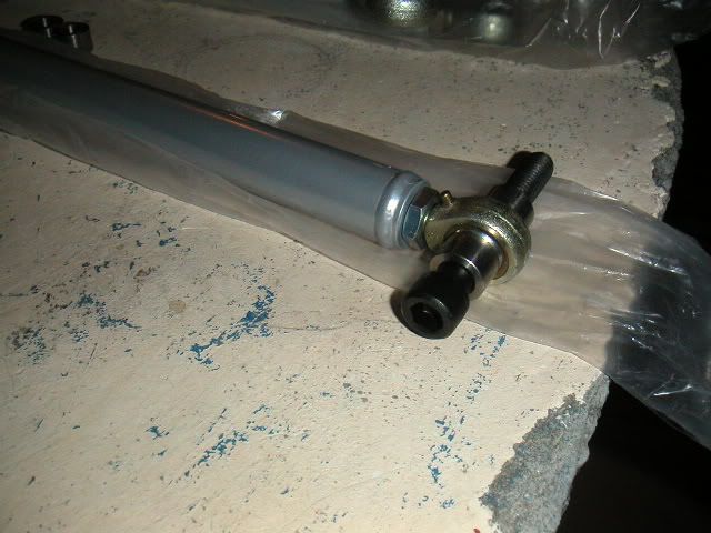

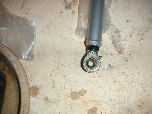

joins are ROD-ends, or Rose-joints. Panhard rods has one left-thread and right thread for easy adjustments.
4 links are all right threads.

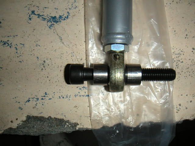

this is how the rod-ends with the stainless steel collars will look like assembled, under your car.
components like the rod-ends are 100% replaceable, just make sure spec is same.
i'm making these for sale, and retail is RM300 per rod. (length doesn't make much difference!)
please PM me for order or for viewing.

one complete set includes:
2 short links
2 long links
1 Panhard Rod
5 right-thread M12 x 1.5 Rod-ends
1 left-thread M12 x 1.5 Rod-end
5 M12 thin lock nut
1 M12 (left thread) lock nut
16pcs 17mm stainless steel collar
4pcs 12mm stainless steel collar
all add up, total:
RM1500
now special promo for launch, RM1350
other promos:
4links set only: RM1100
william-san
wait, i have find weighting scale! :P
william-san
weight: 4 links : 3.2kg
Panhard Rod : 1.6kg
