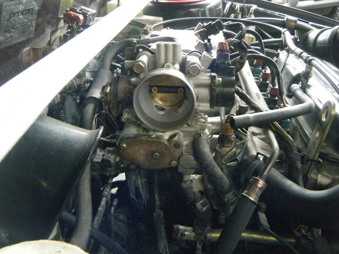

I guess my FC really sucks then. If on city driving, FC is even worse. Throttle body seems ok the last time I checked it. Will change the plugs soon since that is the cheapest.
attachment.php
