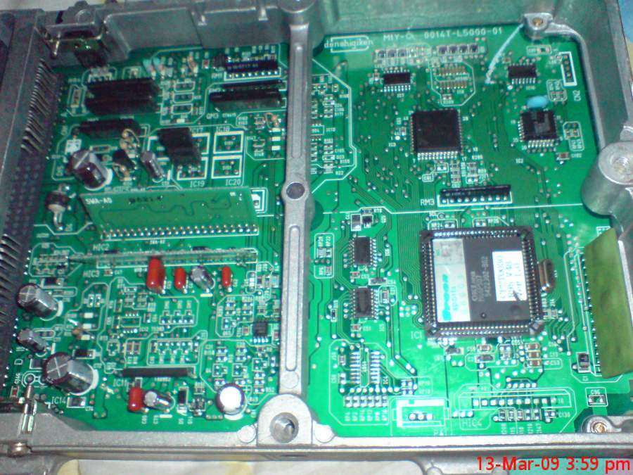

Can i use rechipid ecu and vafc togather? I recently just convert my tranny to manual and change to spoon rechiped p2t ecu but will it work well with vafc or i have to take out the vafc? My car still havent sent for tuning.
I don't really understand tuned chip and copy chip. Copy chips are immitation right? What about tuned chip ?
gogo...go find bro jin..but u have to send ur whole car come PJ from sabah haha,...
bro death..u just open ur ECU cover snap a pic or few let bro jin see kao tim lor ....
ur is spoon ecu ma..
That day i went to my mec place he suggest me to use mugen obd1 rechipped he say will perform better then this spoon obd2 ecu. As far as i know hodata s300 is the best for obd1 not sure bout mugen. Any comment bro jin?
