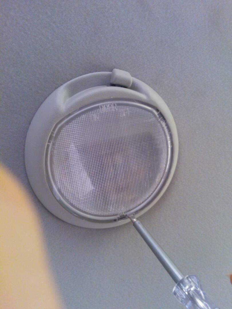

Okay, 1st, open the dome light using a flat screwdriver(test pen) or whatever that is that fits the hole.

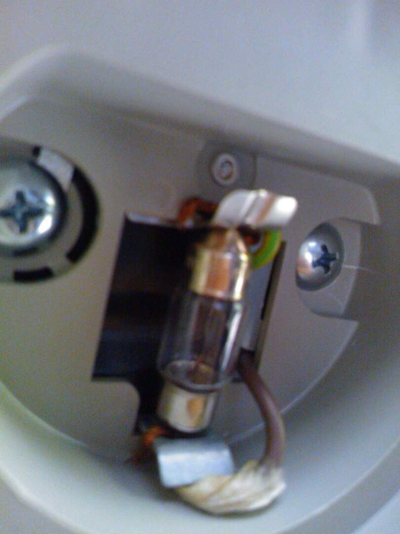

Now you need to test out which part of the bulb is -ve and +ve. So, pandai pandai lah, okay? Not being lanci here but some of the things u need to learn by urself in order to learn/adapt quicker next time. Mostly is common sense. :biggrin:
Now, hook your wires with ur bulb. I used a 5SMD LED bright white. I myself hate blue, red, or any other colours than white and warm white. In my world, the colours mean lala(typical chinese style, aka ah beng).
You hooked it already right? Please hook it accordingly to avoid burning any fuses, i burnt my memory fuse.
SWITCH TO OFF POSITION
Take out the ori bulb by pushing either one of the metal part. Now u can on it again because we need to test out which part of your bulb holder is neg and pos. Test it using the wires that are hooked on to ur bulb. Only 2 tries are needed. *Common sense* :proud:
When u found out the position, switch it off, hook the cut split ends in to the hole of the bulb holder.
Thats basically it. How you hide your wires and bulbs are all up to u. I drove the wire in the roof 'carpet'(as u can see from my pic), thru side pillar, in the door rubber, then under the dash.

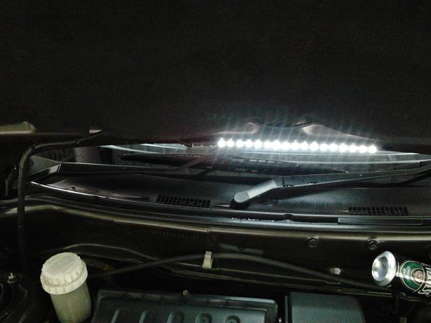

Btw, I have done it on my daily ride, albeit in the engine bay. Having a bright engine bay is useful.
I tap the line from battery (+) terminal with one 5v fuse. Another line tapped from the engine hood sensor so that the led stripe only turn on when the engine hood is lifted. I make sure the wires are adequately protected too by masking the connection and inserting 'em into a small hose...which serves as an aesthetic purpose as well. Lousy wiring job but it works :biggrin:

Here you go! A picture of my lousy daily ride with the engine hood up.
The LED is about 15cm in length. Had been around for 2.5 years.
Pic was taken in the evening. The covered hose hooked to the firewall is actually the 2 wires.
Ignore the Pepsi Ginger ale :biggrin:
