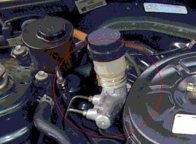

Is brake booster = brake pump ?
This thing right ?
no...no..no....
the booster at the back of the pump...
that 1 at the wall.....
https://www.zerotohundred.com/forums/attachments/67866
my fren told me this 1....
viko5805,
sorry i confuse btwn brake booster & pump, previously my brake pump kong not brake booster :") ...From what i read, the 'check valve' at the booster is function to allows air to be sucked out of the vacuum booster. If the engine is turned off, or if a leak forms in a vacuum hose, the check valve makes sure that air does not enter the vacuum booster...I think mybe got problem, maybe the hose leak...
just my 1 cents ..hehe
Oh, in that case, my old Aura is brake pump kong, the oil leak from the pump... So I guess different case, the earlier symptoms I got from this leak is spongy braking system, can keep stepping further and further in (even with the brake level max).
Changed to the Deto pump + booster, everything solved.
