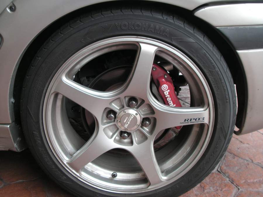

Bump: here are some pics
ignore the fake brembos lolx

Ok...dude!!!
I think ur tyres should be 205 width...is it?
Let me share my experience to you!!!
ADrive R1 is a performance tyres...
If i'm not mistaken!!!
This tyres always complain by all the user that alignment out!!!
So the reason is because it very very flat on the tyres surfaces!!!
i think ur chamber has been adj imbalance!!!
U can try which(left or right) cornering is oversteering!!!
Most like i guess will be left!!! Turn left oversteer!! Rig?
Otherwise, check ur hotbits adj coiler height!!!
I may sugeest u to put higher spring rate rather than higher ride height!!!
Very dangerous oh!!! 17" already so high lioa leh!!!
