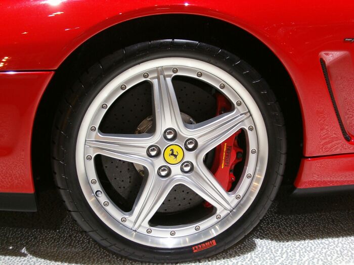

Wah khoyos, wanna ask us to use carbon rotors ka?? hahahah..
bro, the pads is metallic = metal compund, not metal 100%, there for expension is not proportional to iron right.. plus the pads are not restrained from expanding.. the rotors are restrained at center..
