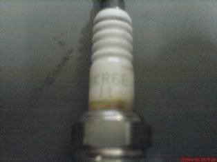

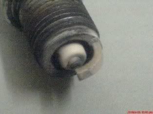

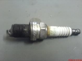

These are the plugs I dyno'ed with.. these are still in working condition, and a testament to how well the stock plugs work.
Cheapo NGK R plugs.. :P BKR6E-11.. and they're well past 20,000kms of use when I dynoed with them. about 30bucks or so I think. As you can see.. the condition of the spark plug tip is still quite okay after 35000kms, which is the due date of my oil change and I usually do various stupid stuffs at this time.
They're still working, and I'm changing them only because I'm heading to KL again next week to settle some family matters. And I'm not about to try and find out if they'll last the near 1000kms round trip. So, I just took them out today while doing the compression test and replaced them with these.. forgot to take pictures of them B4 I plonked them in.. So no pictures :P
I'm telling you.. there is no difference! I'm going to take them out and gauge the plug colour on friday/saturday after bumping off the rev-limiter a couple of times, if they don't start fouling first.. I think they shouldn't and should work just as well.. time will tell.
