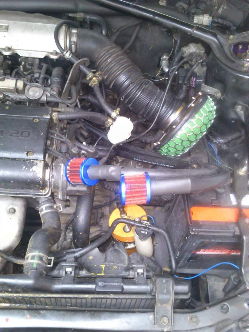

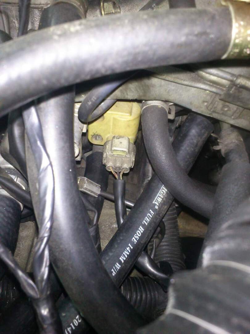

1st pic.. ISCV and intake manifold suction holes coverd by the 14mm fuel hose.. can't really see the ISCV hose.. coz it's behind all those things..
2nd pic.. the twin air filter.. 1 for ISCV and the other 1 is for intake manifold.. before i hide it..

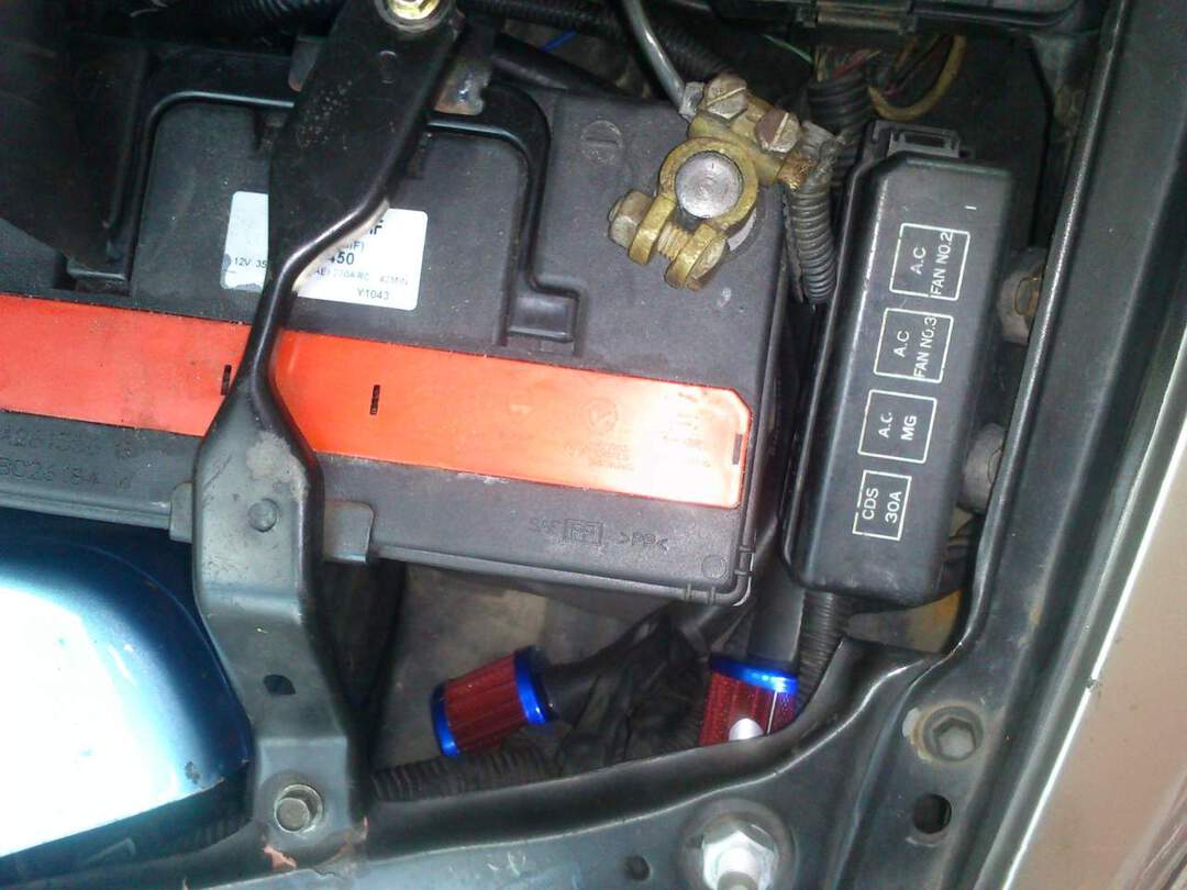

3rd pic.. hidden near the battery :biggrin:
p/s : Nappx.. ur car so powderful lah.. what powder u use? hehe.. i'll be doing more mods after this :wink:

The CAI setup for ISCV suitable for open pot anot??? i mean using trumpet can ngam ?? if yes i wanna try :-)
At first i also thought to use fuel hose, but black hose tend to absorb more heat.
I'm still searching for white color durable hose
Eh.. No la.. Rubber doesn't transmit heat
No matter what color they are
I should follow your route. It can avoid hot air from radiator. My current setup is the hose definitely behind radiator fan. Maybe the hose heat up by the fan.

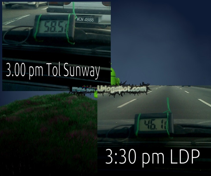

BTW, bro zul you may add heat shield as in this picture to avoid hot air from radiator. The result is very impressive.
Intake air temp can be lower up to 10 deg celcius and more. Plus, add CAI hose as well to get better result.

me2kimi : where did you get that temp meter? I've been looking for one for ages
