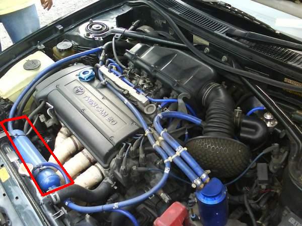

Also, what is this used for in the pic?

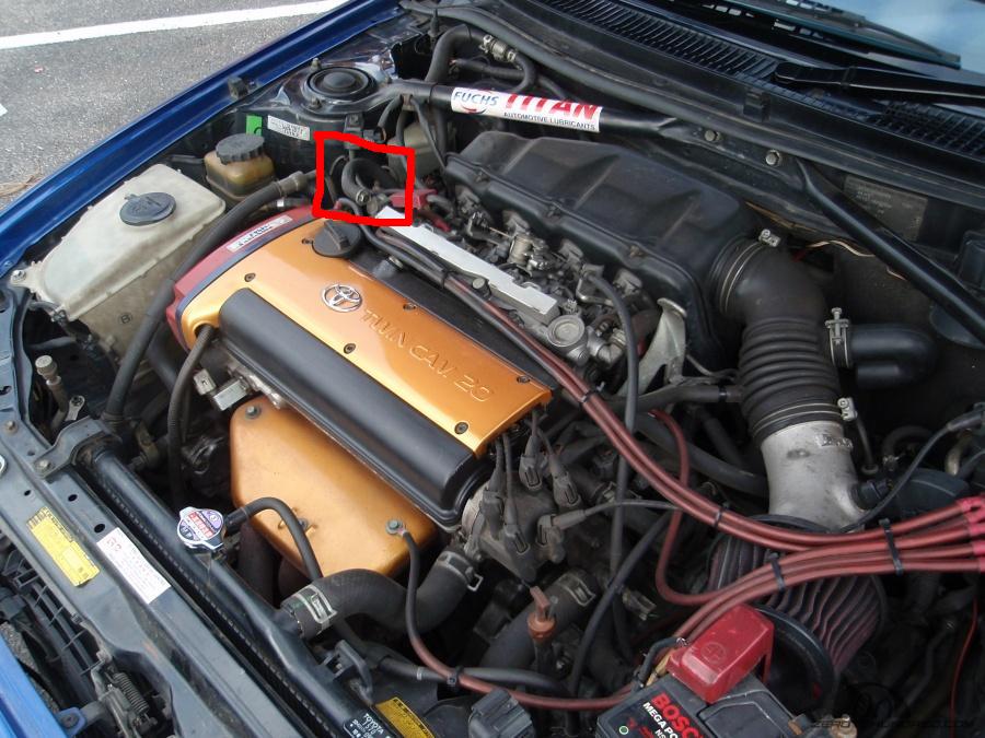

Also why is the compressor hose for BT goes above timing mount and SVT goes below? And I noticed an additional hose that some ppl just put a bung and some (like the pic in my 1st post) have got a sump. No idea what's that for?

Dude, that picture you posted is not 4AGE 20V Blacktop. Its 7AGE 20V Blacktop (1.8cc)! :adore:
The blue canister near the radiator is actually some gadget attached to the brake booster. Original BT is not like that.
For more info, you might want to ask the owner directly about that setup.
owh really? wow, nice mod!:adore: thanks for the info bro..
I got another pic from the forum with the hose that is bung-ed up...
