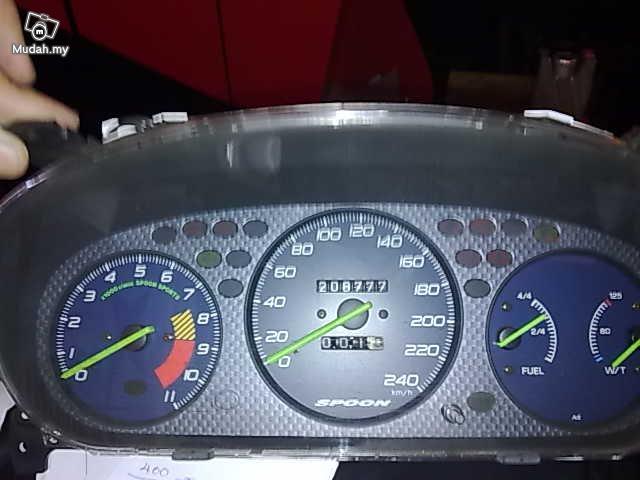

I see. But according to Spoon EK9 Limited Speedo Meter, it shows 80 or 90 degree (cant see it clearly below photo) is in the middle & 125 degree for the max. Anyone can confirm? Please refer below for the photo...
As my uncle's Gen 2 meter, in the middle of the water temp shows 90 degree. So if Spoon meter show 80 degree in the middle, which is correct?

Just take the standard meter as a guideline. It is not linear so no point comparing. My datalog was showing 70 its already in middle 120 still in middle. Then it will suddenly jump very quickly to red 120+. In other words, once you see your cluster meter going up, your engine is really overheating and you better stop at the side of road to cool it down.
