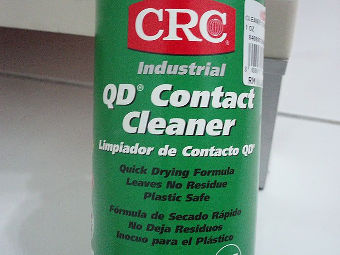

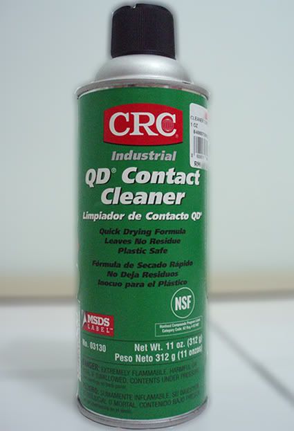

the contact cleaner you are mentioning about is it the same as the some that uses to clean the cd and dvds ?
wfhan
4,000 RPM
Jan 9, 2004
4,339
96
selangor
sifus...
there are diff type/grade of contact cleaner.. but make sure u use those that
stated "Safe on plastics".... i tried to find CRC MAF Cleaner, but maybe i didn't
expand my search area.. therefore i got this & it works for me
