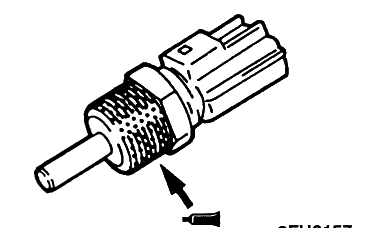

I think it's more of a temperature issue. Possible the engine coolant sensor could be sending erroneous readings. The ECU requires these readings so that changes can be made to the engine’s timing and fuel calculations for optimal performance, as engines require more fuel when they are cold, and less fuel when they are fully warmed up. Tomorrow, when the car cannot start, I will try to unplug the sensor & trigger the ecu to fall back on default values. See if that will start the engine
I found a thread where someone reported it caused hard starting in the cold > http://www.4gtuner.com/topic/22023-coolant-temp-sensor/

Anyway, today's another rainy morning. At 9am, it started on the second kick of the starter :dontknow:
Yesterday evening, I did clean up the area around the coolant temperature sensor.
