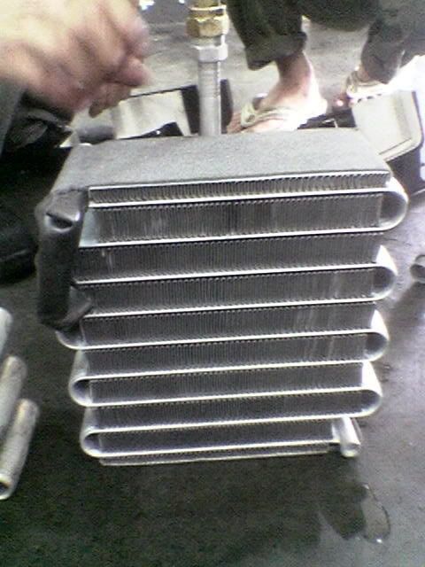

This is the main problems happen to my car which the air-con always
not cool not matter how i send to workshop service it.
I had think of few ways on this, including recently i just service
radiator, use good coolant, change radiotor and air con fans,
change most of the parts in air, change air con gas but still the same
not cool. I had think another ways of use vcool which now my
windows all are using tint cool.
Any one can help me up on this?
lim2000
Junior Member
Aug 9, 2008
9
1,501

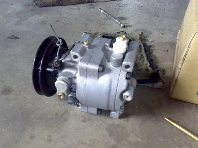

i had change the colling coil. it cooling coil is not compressor.
craziqbal
Mar 23, 2006
111
yep..try checking ur compressor..after changing the compressor of my iswara..the air-cond is so cool u wouldn't believe it..my car doesn't even have tinting..:proud:
ultra_ZX
Aug 17, 2008
71
1,506
i'm agree with raymo26,change ur compressor to denso...it so damn cold...
