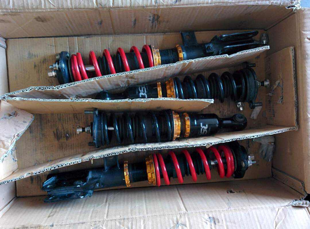

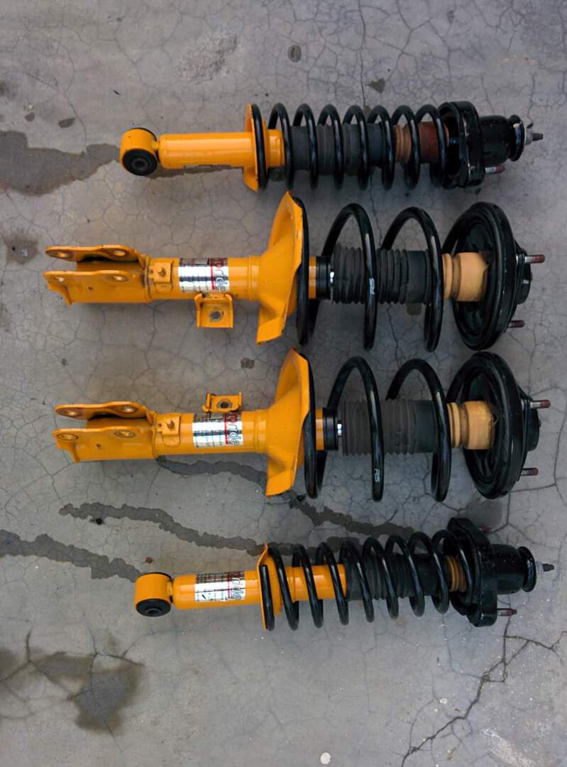

Hi guys and hear my story out.*
Need your opinion. After a bunch of other upgrades i decided it was time to mod my suspension.*
My car is a proton inspira btw.*
Initially 10 months back i started to change the spring to proton R3 springs. It was great, good compromise between comfort and handling. (level was 3 fingers loose back and 2 1/2 finger front)*
After a while my driving improved and started to feel that the suspension could not handle fast corners.*
Thats when i change my absorber to proride sport (yellow). It was good but i was disappointed when it did not give any more drop. But on the upshot handling has been increased.*
Then sebab gatal tangan, decided to change to adjustable (ISC, used 10 months) in view of:
-wanter to drop the car more (3 finger tight rear and 2 finger tight front)*
-better handling and control
After i changed i noticed that although the car felt planted taking high speed corners,the car was damn bouncy, especially at the cyberjaya-putrajaya-puchong highway.*
My question is what should i do next, i already tried changing the springs rate from stock, 8k front and 6k rear to 6k front and 4k progressive rear.*
Any sifu willing to give input.*
Tqvm*
uploadfromtaptalk1427880631456.jpg [https://forum] uploadfromtaptalk1427880588906.jpg
Tqvm*
View attachment 541116 [https://forum] View attachment 541115

Hi guys thanks for all your replies.
The setup i want i a slightly harder setup than my springs and shocks combo but will give a good drop and good performance balance.
I don't mind the suspension is hard, the problem is that it is bouncy on certain roads.
I thought of titan and rcs but both got 2 big cons.
-Titan > the lynspira group did a group buy on titan, but then they all had weird noises from the shocks. Also there are some members complains of bottoming out.
-RCS >> expensive, but that's not the biggest problem, the problem is service is rm350 per piece every 20k/1 year.
There is no way i'm gonna pay rm1.5 k just to service my shocks every year.
I'm thinking that maybe my used adjustable needs some servicing. What do u guys think??
