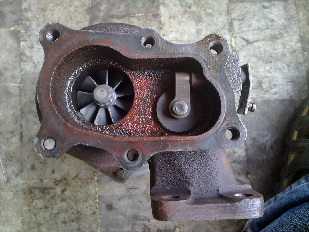

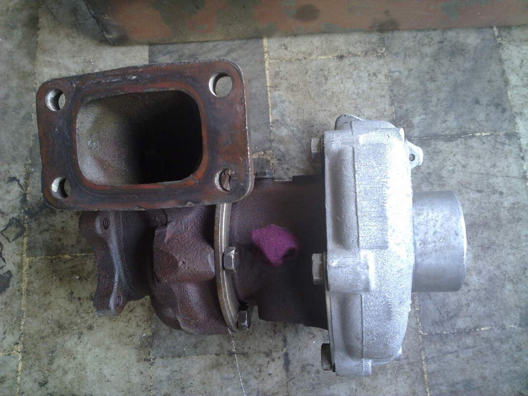

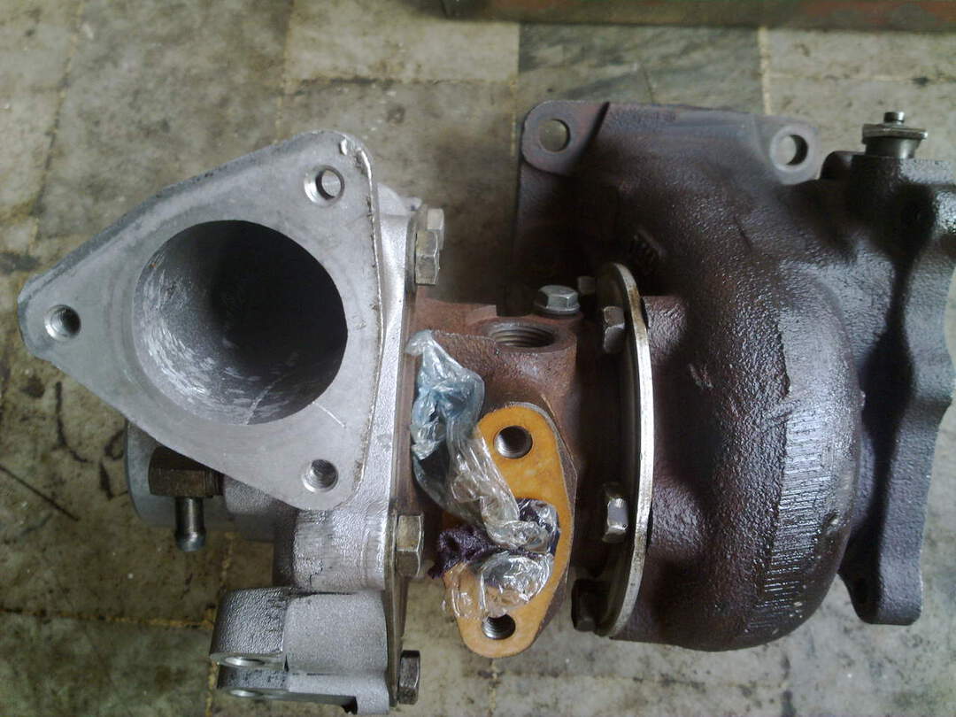

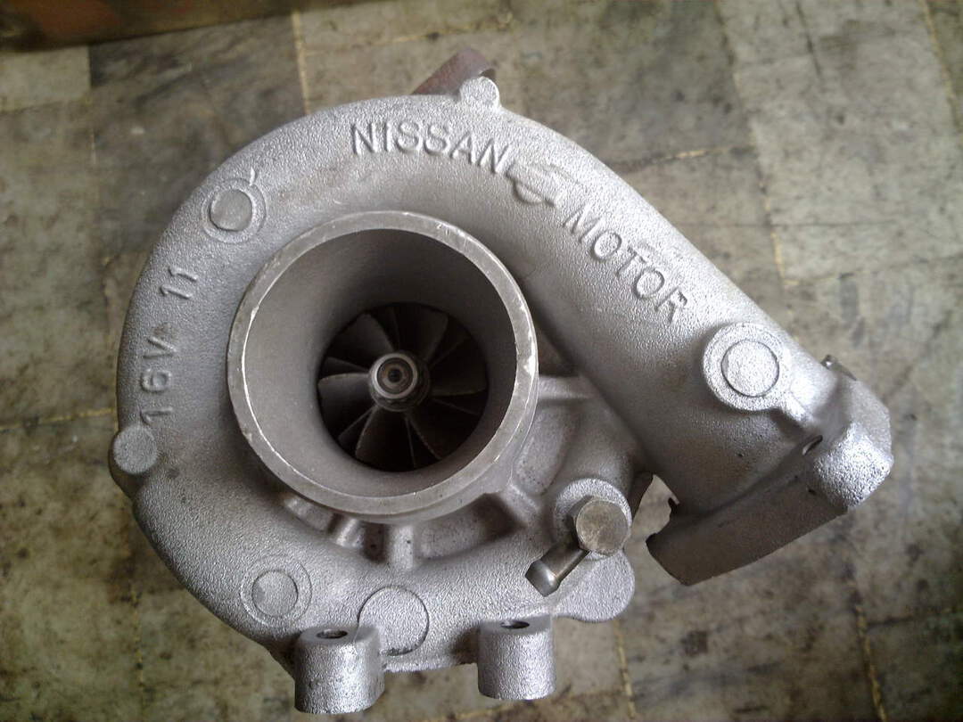

@Veloc
Let me clear you sir previously I was using 4EFTE Turbine CT-9. I was running the same boost 1Bar. On dyno figures were 146Whp. After complete aggressive tuning. Later within a month I changed the turbine to Nissan Dual Ball Bearing and boost was the same 1Bar. With the change of turbine my car leaned with 250CC injectors. I had to upgrade my injectors to 300CC and had to re-tune. And with the figures I was amazed.
http://www.zerotohundred.com/newforums/car-modification/365308-my-mitsubishi-lancer-4g13-turbo.html
Here are the picture of turbine which I upgraded too.
