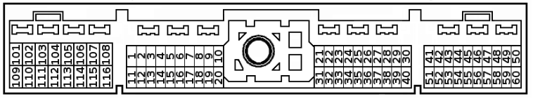

pimpin the code showing error 33.. so its engine speed signal error.. ask him to swap his CAS.. if still not working check the CAS wiring continuity to ECU (pin 4 CAS to pin 41 ECU & pin 3 CAS to pin 42 ECU).. also check pin 2 CAS for power and pin 1 CAS for earth

Thanks bro, good to know that I managed to talk him through the first part but also relieved to have someone confirm that its Code 33. I'll try to get him to do the above. Thanks bro! :adore:
