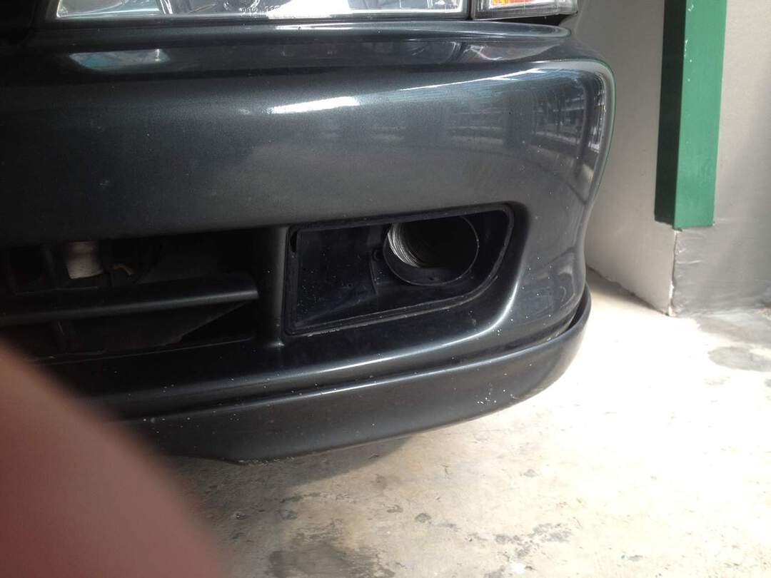

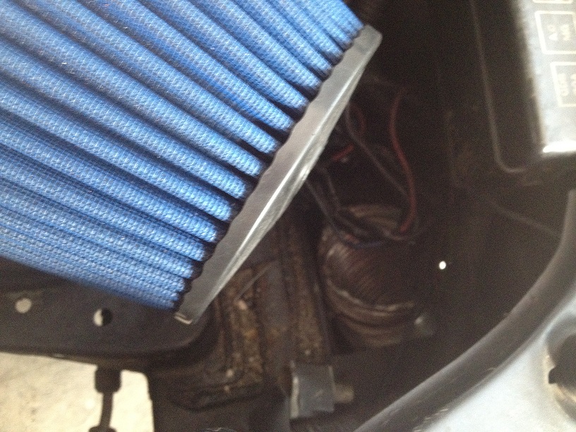

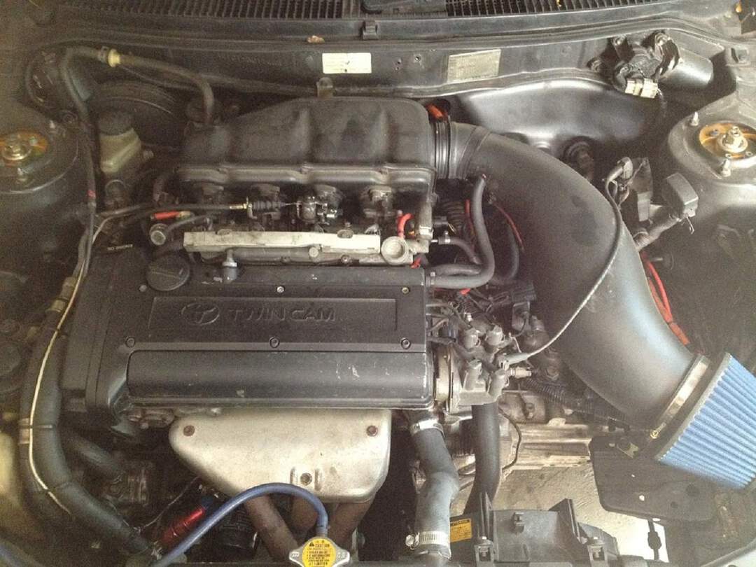

and also hmmm i am running stock air box with fat tummy B series piping to cold air intake. u all tink will it b better than trumpet without cold air intake?
here is the pic hope nt too small lol
