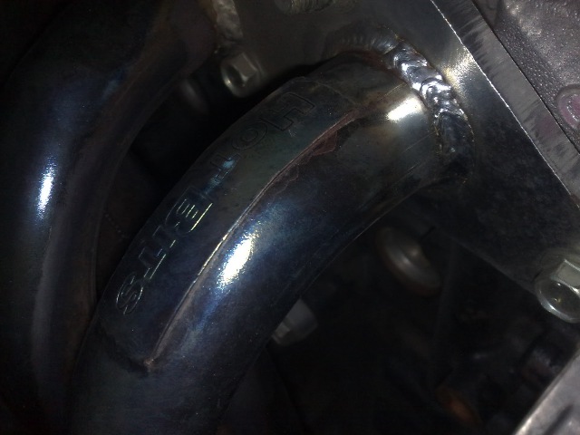

Good info after reading this thread.. Maybe will do little bit mod to my current exhaust setup..
My Ride: Satria Neo 1.6(M)
Current Setup:
* HotBits 4-2-1 Extractor (bought it bcoz the long secondary compare to PZ)
* 2" Midbox
* Straight Flow Muffler (BIG)
* Still using stock piping.
Sound, kinda bassy.
Result: Improve at low rev specially @ mid rev.

hi bro, thanks for sharing ur mods..
i just wanna know when u mentioned urs still with stock piping..u mean downpipe? u only changed ur extractor+muffler right..what's ur stock piping diameter then?
and the bassy kinda sound is it from ur new exhaust+extractor mods or u just tuned ur timing at lower rpm?
