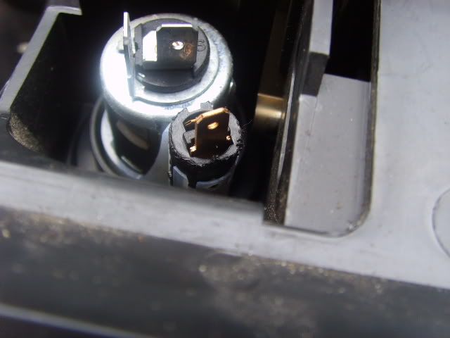

my car is in for a service so these pictures are off the internet
despite being off the internet they are very exact and precise
back of the cigerette lighter:
TO EACH PRONG THERE IS ONE WIRE, THREE WIRES IN TOTAL

back of your cigarette lighter has 2 connection... positive and negative...
from the photo u provided above, the neon u gonna install has 2 wire to connect... red and black...
so i assume red is positive and black is negative... its pretty simple direct connection...
yes u can tap 12v DC source from cigarette lighter....

so the third little pin to the top of the cigerette lighter i just ignore? and keep it how it is?
and so do i wire the wires from the neon kit to the back of the cigerette lighter WHILST the old wires are stil attatched?

the 2 pin from the main cigarette lighter should be the positive and negative terminal... the smaller looking tower is for illumination (LED) of the cigarette lighter... can ignore that....
yeap... u can just tap the wires directly to the cigarette lighter without removing the old wires... hence, u will still be able to use your cigarette lighter...
