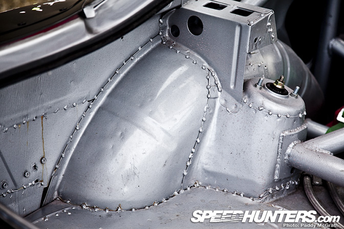

if dong full car spot weld will be much more stiffer than oem chassis, that one is race preparation for race dy
But do you think if lets say someone do a full spot weld on a Wira 1.5 or maybe Wira 1.8 C99 chassis, can they achieve the kind of stiffness in your CD9A? I don't think so after seeing your photos of areas with reinforced welds in Evo.

Much more stiffer, mean for race use

Even after spot welding, will the chassis be strong enough? I remember one of your old quotes about a Putra with chassis cracks.
Your quote back then.
Yes. But key word is "regularly went track". If you're planning to go track regularly - then I'd probably do more than spot welding. If it's just a daily drive, cracking a C99 chassis is going to be a tough affair.
I see. So it is actually possible to further reinforce a weaker chassis with this race use method.
So, that is the key point then. If one does not go to track often, a C99 chassis will be strong enough even for powerful engine swaps.

For me more stress on chassis driving on the street than track, due to special pathhole road in bolehland
Can potholes actually crack a chassis? Cracking wheels, yes, but chassis? :confused:

years ago , not to bash or what, but there is a perodua viva owner put on photo to ask help for repair strut tower,cause hentam lubang besar,rim bengkok crack then strut tower spot weld also detached.

i guess if the pothole is large enough and the force was great enough to bottom out your suspension and transmit enough force to mess everything up... yeah i guess?
