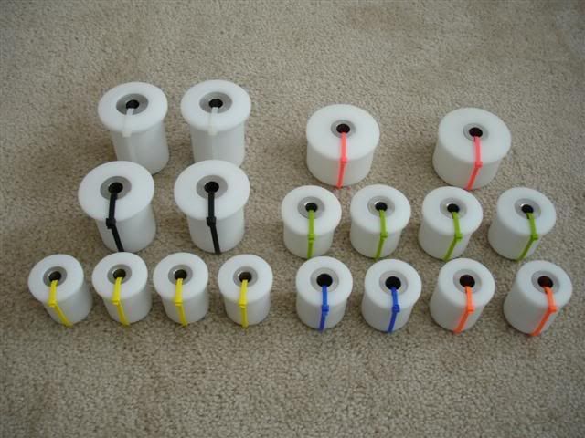

it is best to change out all if the wallet allows. Its night and day difference. I bought my set off the group buy. Dupont Delrin material. It was a complete set plus then the smaller bits here and there from Ray Malloy.
Super pro's local distributor was horrible then when i called to inquire. So i went with Delrin. From what i've gathered, superpro bushings are musch stiffer than stock. Its great for handling but like all aftermarket parts it somewhat sacrifices ride quality.

dev... you bought those... i almost decided to purchase them... but i didn't....
these are the ones that's in my car running at the moment... spherical bearings...
normally these are being covered with rubber to avoid sand and dust going in...
these stuff cost ALOT....
what are those? i also have the balance in oem. what make are they?
