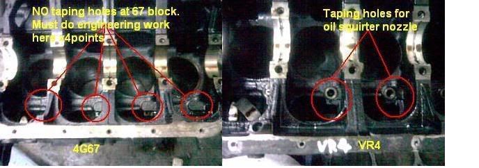

We done many 67 turbo.oil squitter can do.send to machine shop.block is same with 63 turbo.At brisbane we finish 2.4L stroker with GT40 and running methanol.890whp from FWD dyno dynamic.Thanks to Race Enginering from Sydney build the strongers Rod and Crank.The engine boost around 40psi.we can boost to 50psi...why?coz we have the O ring at the block.Never leakkkkk.

Anybody need a pic for O ring,PM me and we can do for you.But not local macine shop.

mine is 4g61 NA block but turbo edi..
put oil squirter taken from vr4 block... just plug n play..
no need modified.. just open the nut and put the oil squirter
not sure the 4g67 same or not.. but for 4g61 NA block got tread for oil squirter oledi..
less i think same... just 4g61 got short stroke than 4g67

Price is not too xspancive.we do only short block for u.
1. 2.4L Crank
2. O ring deck for block and head
3. Wiseco pistons 8.5:1 CR
4. 4340 Cromoly Rod
5. New ACL engine bearing
6. Check Crank walk
7. Crank Balance
8. Oil squiter
Cost about RM 7900 including 2way shipping.
Give me block and head.
Block must send to Aussy for do the engineering work.and stuff we fix it at the shop in aussy.

But the 67 block can push 650whp.Change the pistons, rods and good valve springs.Cost may be around RM5500....:burnout: :burnout: :burnout:
