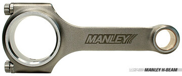

Hi sifus,im planning to taking plunge of swapping 4G64 Evo engine
Any sifus2 here running one?What is the issues and problems?
Im targeting 400+ hp only.The engine already in running condition in my friend horse.
He plans to sell his car hence dekitting the engine which im planning to swap with my stock evo to this engine+top up cash.
Really appreciate sifus help:driver:
This is the engine spec
4G64 oem block
4G64 oem crankshaft
Bc rod
Hks cam
Bc cam spring
Cp 87mm piston
Acl bearing
Arp headstud
850 fic
Evo 9 20g
