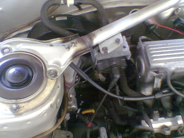

I take the AE92 and make it customize... And can be useable...
Please view the picture below:_:
Right Side:
Left Side:
