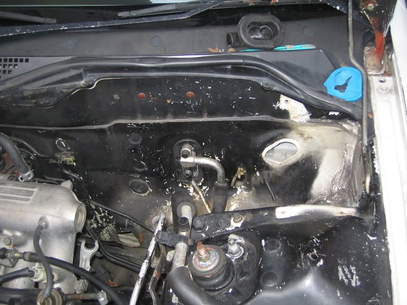

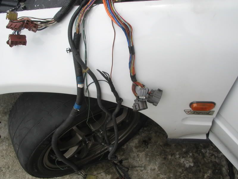

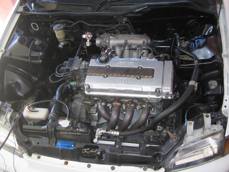

I was in the process to do some wire tuck last time and accidentally broke my knock sensor, coz i was removing all the wires from my engine bay.. ofcourse its throwing a CEL now. Question, when the CEL lights up for the KS, will the ignition timing get retarded automatically after the CEL comes on? or it will just not read any knock and not do anything with the ignition timing. I sold off my ultimate so i can't get any data outta this. Someone clarify this for me please....

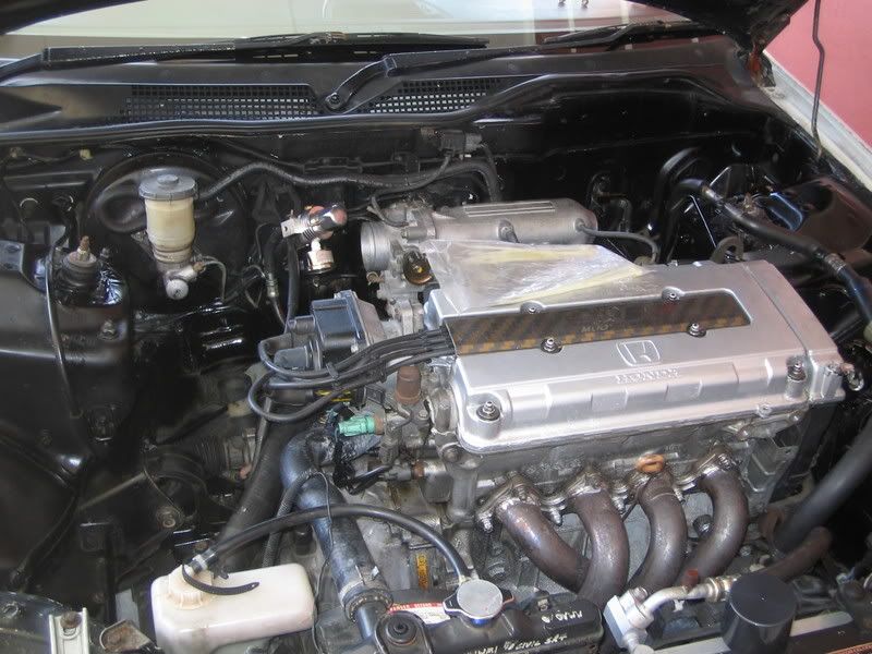

Oh yeah, here's a few pics...
Now the good part....
ADDED:Oh yeah, some people will actually spot something wrong in the picture. Don't bother asking me why hahhaa... i'm just too embarassed to answer it hahaha...
nice mounting bracket u have there... :biggrin:

I asked my friend to search one for me already. Shut up about the bracket.. I knew people were gonna notice that haha.... its not there anymore ok... it was just temporarily put there... :thefinger:

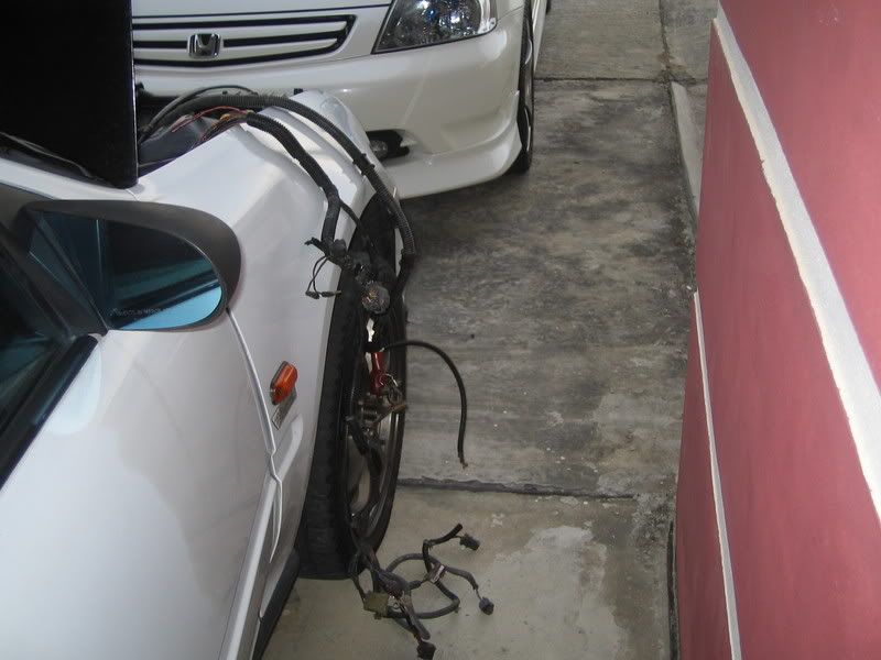

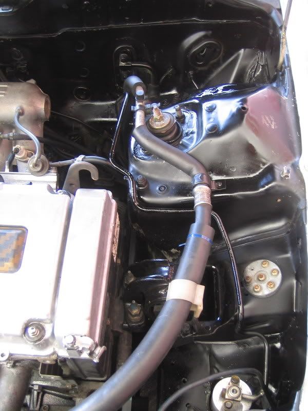

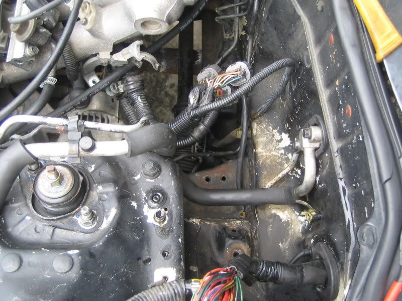

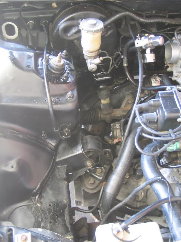

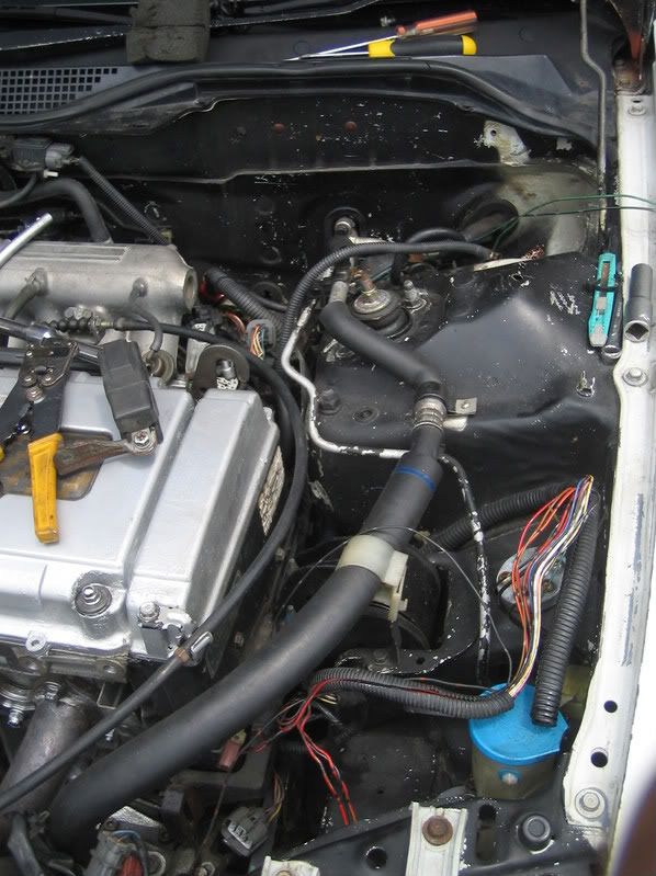

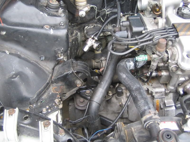

On the left side of the car, the A/C and headlight wires were tucked under the fender, its the same for the right side for the headlights, fog lights and radiator fan. For the injector wire harness, i had to seperate them from the main engine harness by depinning it and grounding it elsewhere on another pin. There was a couple of wires that needs extending because according to my reference from honda-tech, they didn't have to do it because they're left hand driven but for right hand driven cars, it had to be done. Starter wire, grounding, battery cable had to be soldered and extended and some other wires that i can't remember. Main engine harness were combined together to go through the firewall hole that i made...
