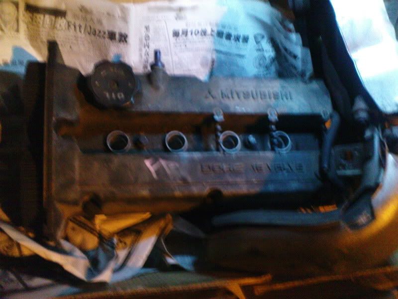

BEFORE

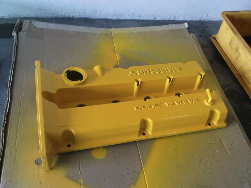

IN PROSESS
SEND TO MODIFICATION MECHINE JOB

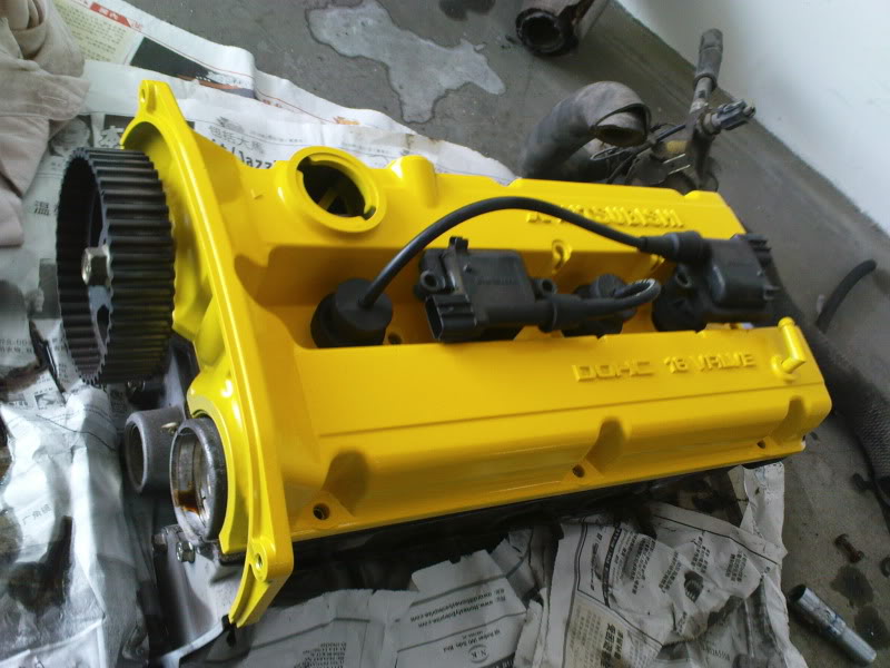

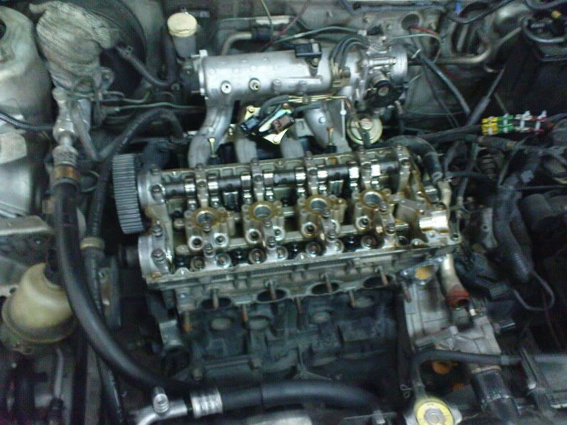

INSTALL PROSSESS

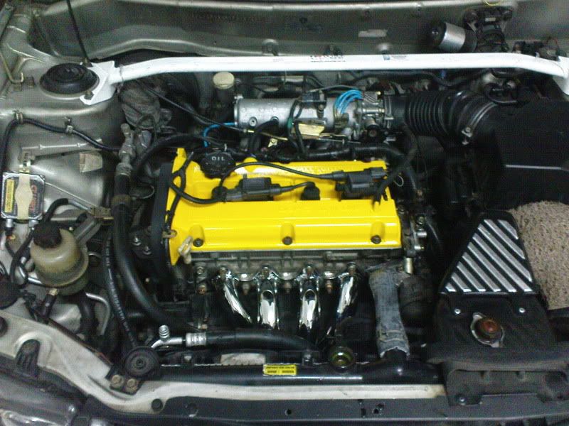

DONE~~~~~~~~~

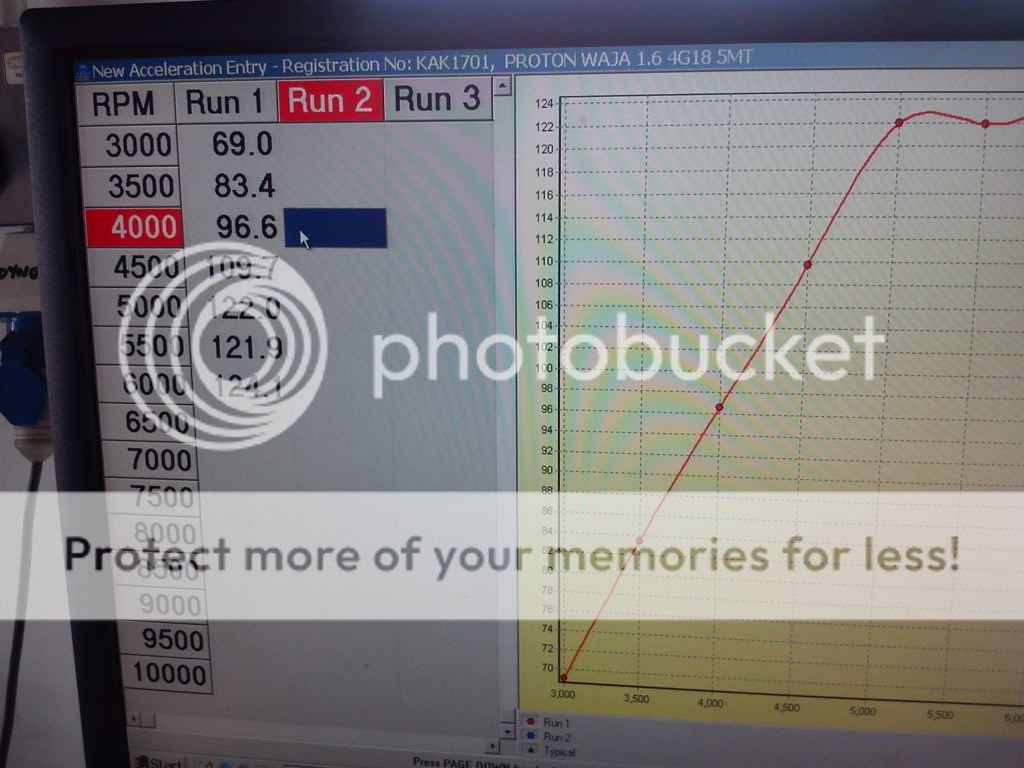

whats the different in terms of torque n power..
care to share the chart between the original 4g18 and the converted 4g18 doch..

hehe i dint do any DYNO.but i can sure is got driffrent. welcome to test drive first.

PICTURE is say all ,wiring n ECU all use waja 4G18 ori.
