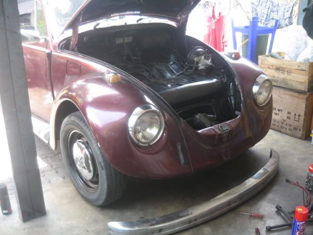

sorry to divert a bit from the discussion. I saw the bumpers of the beetle in the pic posted were all shinny-shine-shine. I'm thinking of getting my 1970s corolla rear bumper chromed. Is there any good place in KL to do chroming? It would be nice if the place offer bumper repair also as my steel bumper got rust holes/pits and some dents....*sob-sob**
thank you, guys
hi ken yeang...the bumpers are originally chorme....thats why...its sine..
for a few last years ago...i try to do rechroming at penang....the quality not so good as the original...
so i decide to fine original bumpers..the chrome is very good n depend how u care it...
in kl never heard that shop do chroming...maybe all sifus in kl noe it...hehe

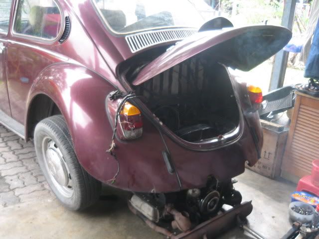

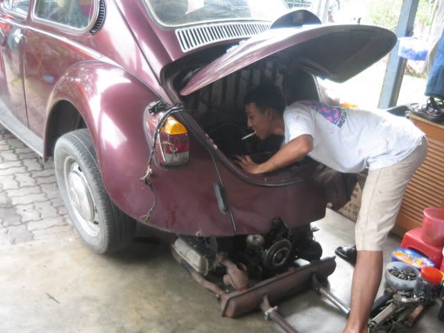

my 3 days project...
this i wanna share with u all....
my bro cars 72 beetle german...
first move...

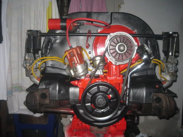

take all useless part...
then...remove the sloppy.. machine....

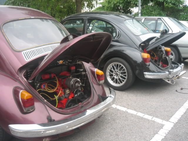

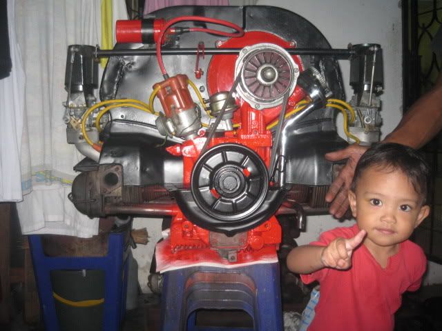

huh....tired already..then assembled it..new part...new carb....
time to put n test it...hehe

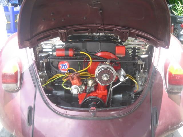

pasang balik..
then...autoshow...hehe
firstly ive got prob with cluch bearing...then...we sole it succesfully...hehe..
so the first move is very good....

mine is more like japs sound coz using 4 to 1 extrator...custom with balance lenght...
this is important coz if ur exhoust is not balance..probbaly it can burn our ur throw out bearing..,ring n cam...hehe
im using 16 inch very berat ma...so short pipe can produce more pic-up...
penah try habis at ldp...nak dapat 90mph...menggigil gak bontot...hehehe at last dapat..hehe

all gear masuk senang n short...that car i sold to my younger brother...dia keluar modal..hehe
wah..tukar enjin or put da twin carb and respray here and there?
