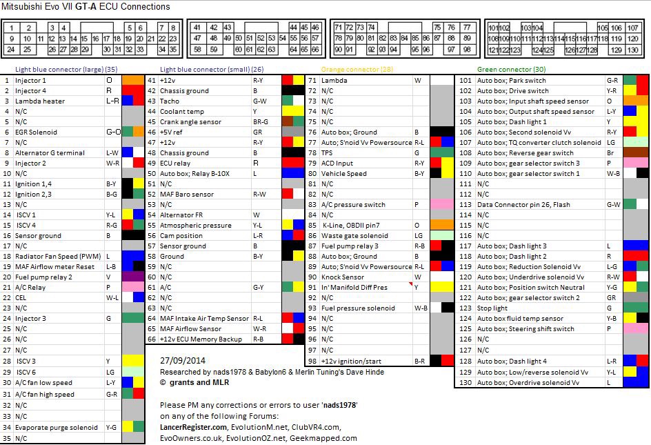

Z zhaktronz Active Member Joined Feb 3, 2015 Messages 27 Points 503 Location Australia Feb 27, 2015 #1 Does anybody know which grommet the speedo sense comes into the cabin through the firewall?
stutzedward 3,000 RPM Senior Member Joined May 27, 2009 Messages 3,416 Points 1,713 Location KL Feb 27, 2015 #2 Try downloading from Apexi webpage for ECU wiring diagram.
stutzedward 3,000 RPM Senior Member Joined May 27, 2009 Messages 3,416 Points 1,713 Location KL Feb 27, 2015 #3 Should be similar to GTA. Attachments image.jpg 251.8 KB · Views: 254
