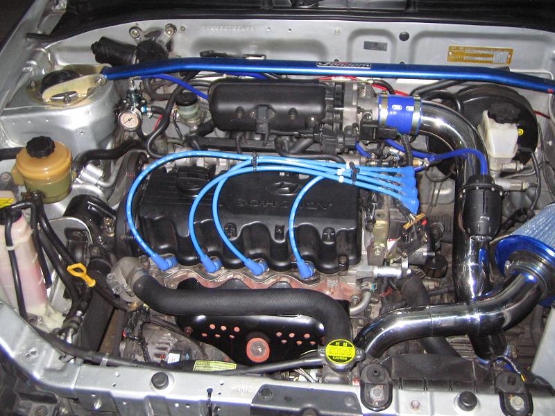

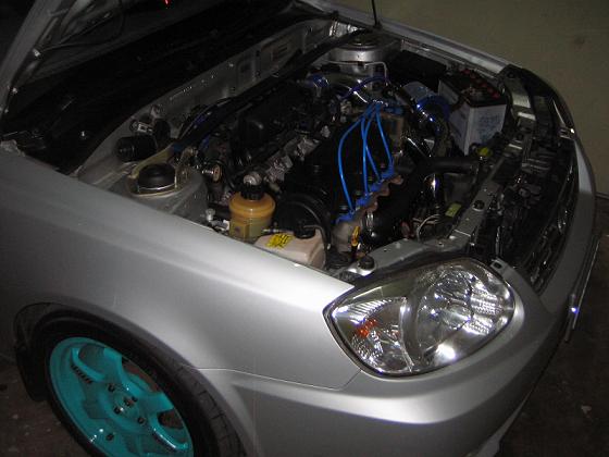

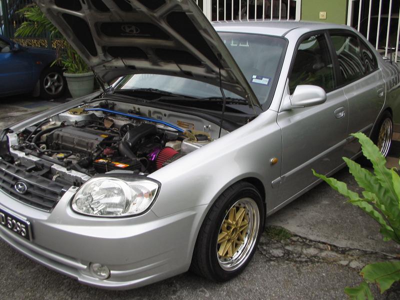

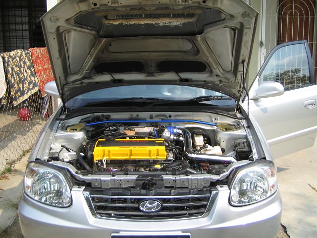

most ppl will said conversion will do better 4 gaining whp but some ppl like to start frm bottom n learn hw power can gain frm???. im newbies in tis gainning power world but if u can see i've done some convertion n BOT both on same car n u can learn pro n con of this matter... happy joy ride..n cheer B'low my pic tq.........
Good job and nice stuff from Mellinium Motosport..If this car running Haltech Sprint 500,all sensor working as normal.But the Microtech can't run for stock sensor from factory(need some modif from crank and cam sensor).But still nice looking.
